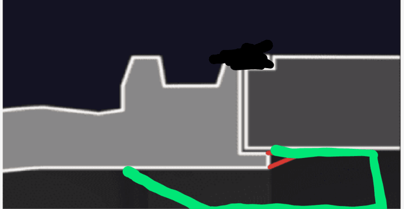

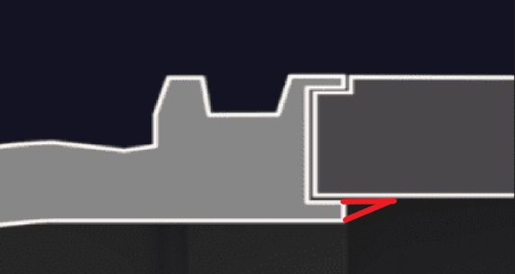

Greg, what might that tapering look like? In this case, might it have been mitigated by adding a gradual taper to the inside of the ring, similar to this sketch?
The annular pockets in the interface rings are necessary to prevent putting the epoxy/adhesive joint in shear due to the deflection differential of the Ti interface rings and the CF hull, but inner lip of the pocket creates areas in the CF hull that would have been undergoing not only axial and radial compressive loading but also have bending moments imposed. The inner lips seem to have been rather short for what my gut feel says a longer engagement would have been good.
As I was posting wheaney has put up a great image.
I'm thinking more like this.
@TugboatEng, doesn't the abrupt transition (from right to left) still constitute a sudden mismatch in stiffness of the combined member? I would imagine that the idea of "slimming out" the Ti lip would be to ease the transition and avoid stress concentrations, while still having a low enough profile to be practical.
Yes, the gap in yellow needs to be much wider. This allows the adhesive to absorb the differences in strain. It's no different than an expansion joint. With that said, I don't know that the adhesive is strong enough to withstand the shear forces hence the addition titanium reinforcement underneath in green.
There are still some step transitions. The fir tree joint was mentioned earlier. The key is that the titanium needs to support the end of the cylinder and as designed it doesn't.
Problem 2 is that the joint as designed traps air and epoxy which makes assembly difficult so I eliminated the outer step on the titanium ring in my finger sketch.

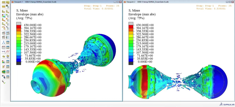

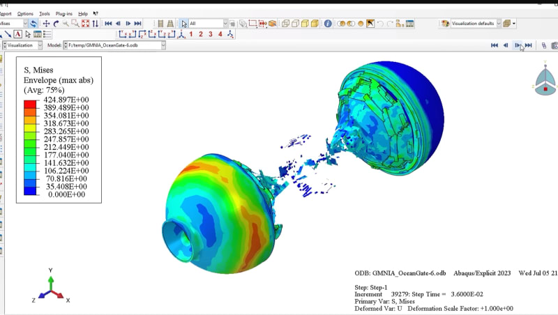

The engineering.com article uses images from
However, the simulation's author appears to not have accounted for the images of the recovered wreckage debris, wherein both end rings were recovered, while their simulation shows the end rings breaking. That would have only happened if the adhesive bond with the CF was stronger than the titanium; there's no way the CF implosion could have broken the titanium rings.
TTFN (ta ta for now)
The author of the simulation has another video which shows a plan view with the rings breaking, but that's not the way the Titan broke. However, it seems possible that the rings deformed sufficiently that all the bolts broke, but the CF then broke away from the end rings and they regained their original shapes.
I, too, thought there was something wrong about how the interface rings shattered in the simulation.
I didn't look closely enough to see if the rings had their material set to Titanium or CFRP.
Perhaps he set the strength of the adhesive connecting the Ti to CFRP to be far higher than it was in practice, it was clearly not strong enough to deform and destroy the titanium, it simply let go.
I do believe that as the cylinder imploded, the face contacting the interface ring rotated and peeled the outer lip free, as shown in the debris photos. I think I'll try animating that - see attachment.
Given the use of paste adhesive between the ring and cylinder I don't see how they could have been assured of no voids in the bond line. I'd hope they applied clamping pressure between the two, but who knows?
I am not familiar with details on Abaqus. Does it have exaggeration added to deformations to help visualization? With others mentioning the disconnect between reality and simulation, I have zoomed in on the views and yeah, the interface rings' deflections look a little suspect.
