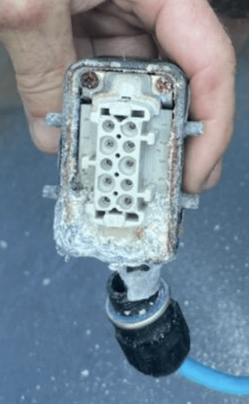

Sorry, I'm a bit jaded when it comes to marine hardware. Marine grade does not imply satisfactory duty. Here is a recent example from the best supplier of that equipment. I guess companies with specific products suffer from small engineering teams that may be strong overall but lack knowledge in specific areas. I have some interesting pictures to post of watertight hatches on my boats that I will share tomorrow.
No one said anything about 'marine grade' whatever. The pictures you have of hatches on your boat are meaningless. This sub was not a tugboat.

My hatch pictures were meant to demonstrate some often misunderstood material limitations. I wasn't trying to explain anything about the wreck, just that the marine industry is plagued with misapplied materials.
The tugboat industry in general is plagued with bad engineering. I am unfortunate that I have to deal with so many problems that I never get to be proficient in them I just have to keep moving on to the next and that's what funds my paycheck. I come here to try to learn better ways to do things.
