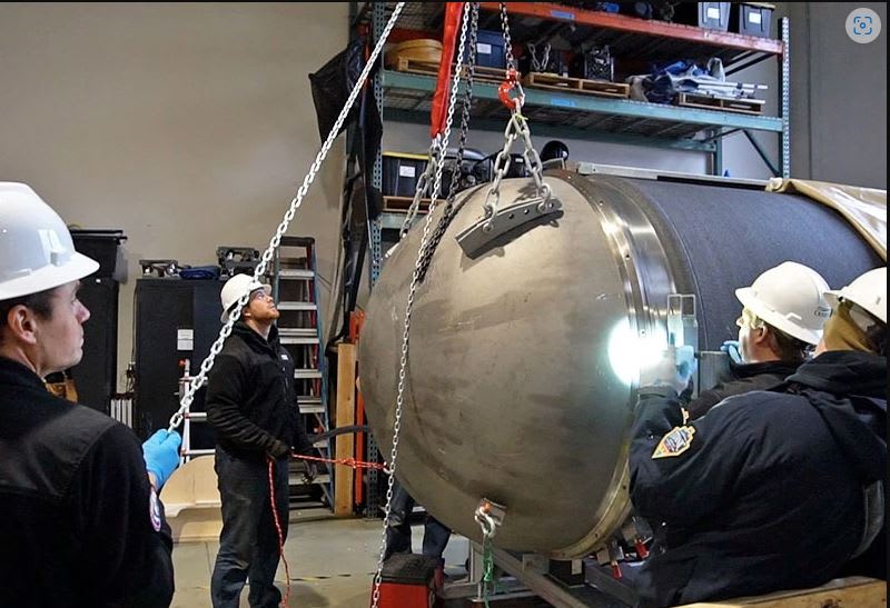

I think there were only two, attached to the CF cylinder and the titanium end caps bolted to them.

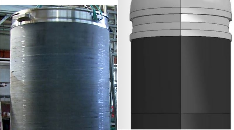

I agree there are likely only two rings (one at each end). See this pic:
The FEA guy may have made a mistake with the ring geometry. Look at the ring vs the FEA model. The ring proportions seem different in the FEA, as though the FEA ring is twice as long as the real one? Dunno.. it's weird

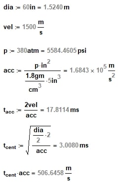

Spinney, there is still a difference between our calculations. My velocity is now 3.28 x yours.
I was thinking that it would be an energy/unit mass equality, but it is equal only as far as pressure on a ft2 or a m2. When pressure is equivalent per unit area, Volume, and hence the mass of water we accelerate, differs by a factor of 3.28. We have to decide on a finite mass of water to accelerate. Not sure how we should do that exactly, but it cannot be more than the wedge segment of the tubes cross sectional area described by the radii of the unit area to the tubes central axis. 1 ft3 implies a layer of water 1ft thick wedge moves from the outer shell to the center. 1m3 implies a 1m thick wedge. As the radaii is only 1.5 something, a 1m3 volume appears to be too large. I think we have to do the simulation accelerating many thin layers of water each moving towards the tube axis. That's beyond my pay grade, so I could just agree that it is somewhere inbetween 1/1000 of my original 200ms and whatever your time is, Or we both could just say ... about as instantaneous as you can get. In which case the FEA model may have accounted for water mass accelerations.
Yep. 3.28 feet in a meter.
My intent was just to put a number on the collapse at the order of magnitude level. This is a weird calculation to try to make, in that the pressure is the same everywhere (or, at least, the difference in pressure over 1 meter is negligible for our purposes) which means as you make your assumed volume to accelerate smaller, pressure does not change, so acceleration rises rapidly to compensate.
The real value is hard to know without much more detailed math, which neither of us are going to do (at least, I'm not... juice not worth the squeeze, etc). I do think that a thinner layer makes more sense - if I had a gun to my head, I'd bet your updated number may very well be closer to reality than mine.
But ultimately, I think if we're talking within the same order of magnitude (which we now are), we're close enough for our purposes.

As for the implosion timeframe, I'd go with the single digits milliseconds after the hull was breached. If we consider one inch area (5 inch deep) of CF accelerated by the hull pressure, we get
So, it takes only about 18 ms to accelerate to the speed of sound in water at that depth, and only about 3 ms to even reach the center of the hull, ignoring any resistance the hull might have provided and the water density changing. 3.5 ms is long enough for the water to fill in behind the CF chunks. We could argue that this might drop the apparent pressure, but halving the pressure only changes the number to 4.3 ms, so whatever exactly happened, it occurred within a few milliseconds.

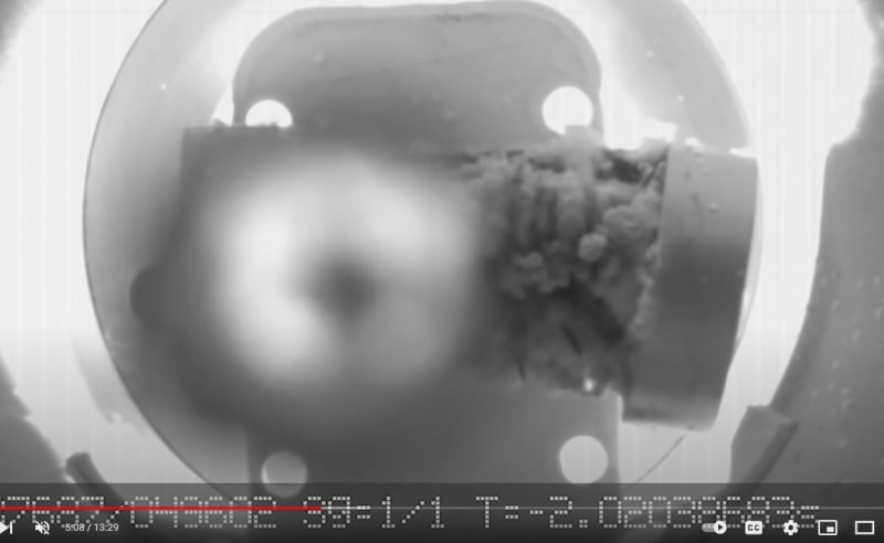

It will if it has to. Look at the Hydraulic Press video mini test implosion, where are large vacuum bubble appears outside of the hull, due to the water going into the hull. This was at 80 bars.
The implosion was far more violent than you're imagining it.
That's the cavitation void.

The conditions inside the limited volume of a test chamber are far different from the vast volume of the ocean.
Yes it's different. It's confined. I was making the point that water will form a vacuum (cavitate) next to an imploding hull if it needs to.
