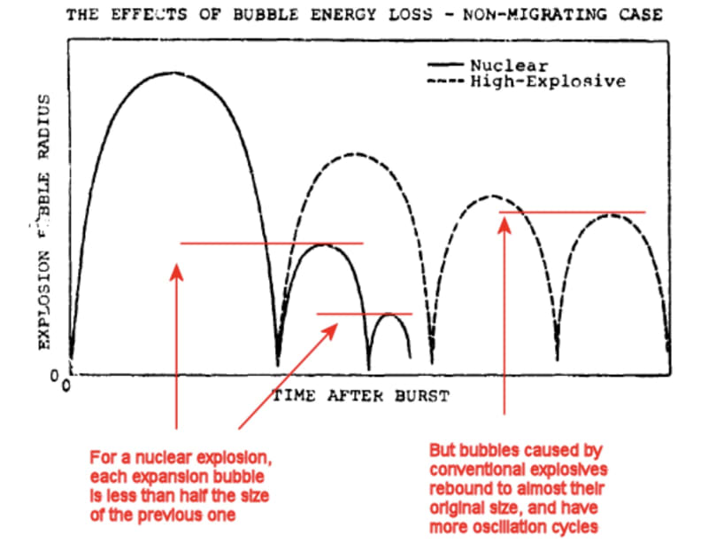

Skinny said:
This is not something being bend under moderate pressure. The scenario we are discussing is literally an explosion in reverse.
Yes it would be supremely violent. There is no
cushioning effect as the air gets compressed. No balancing of internal and external pressures as the sub fills up. This is an explosion running backwards.
Look at what happens with underwater explosives; the explosion grows a bubble, which expands until the energy is used up, then the bubble collapses again, only to rebound again.
In the case of the sub you start with a pre-made bubble, but it’s the same in terms of energetic collapse.
