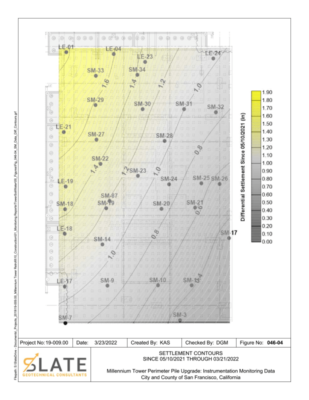

More from the tilt-o-meter:
Compare the last report, 048, with 046. Look at the 1.2 inch contour in particular.
Interesting localised 'dip'. [ponder]

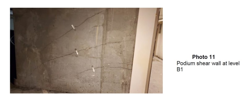

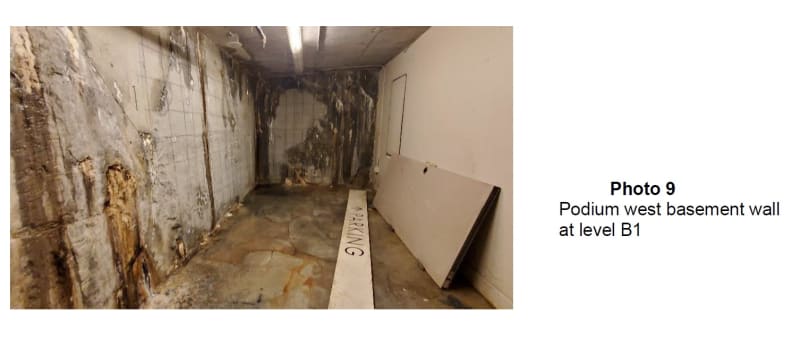

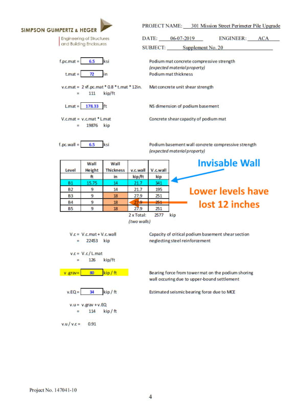

SGH Field Report #7 - Oct. 11, 2021 - (Supplement No. 69) is a collection of photos of the Podium/Mid-Rise & Tower basement levels. Starting on page 4 of the report are photos attributed to the "West Podium Basement Wall at level B1". That's not possible.
The photos clearly show water intrusion through cracks in the shotcrete basement wall but the opposite side of a Podium/Mid-Rise B1 basement wall would be the B1 basement of the tower. The as-built elevation difference between the tower B1 basement and the B1 level of the podium.mid-rise is about 1 inch. The shoring wall tops put below the tower mat at 25.75ft BGS.
Roughly, the historical ground water level for this area of the old Yerba Buena Cove has been about -7ft to -11 SF Datum. At the southwest corner of the site this translates to about 11ft to 15 ft BGS. The only source of water above this level would be the landscape water system, which failed spectacularly on Mission St. & Fremont St. The elevation at the B1 basement tower mat is 15.75ft BGS.

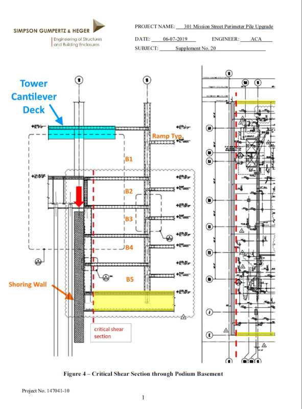

My interest is the result of an ongoing lawsuit between two maybe 3 insurance companies that are arguing over Webcor, possibly having not provided a bond-breaker between the podium/mid-rise shoring wall and the podium-mid-rise basement structure. Results from LERA's investigation of the clearance between the base of the tower mat & the top of the tower/podium shoring wall show a mixed bag of Stayform and plywood. The investigation was conducted at the top of the level B3 podium/mid-rise basement wall to gauge the distance between the top of the shoring wall & the bottom of the tower mat.

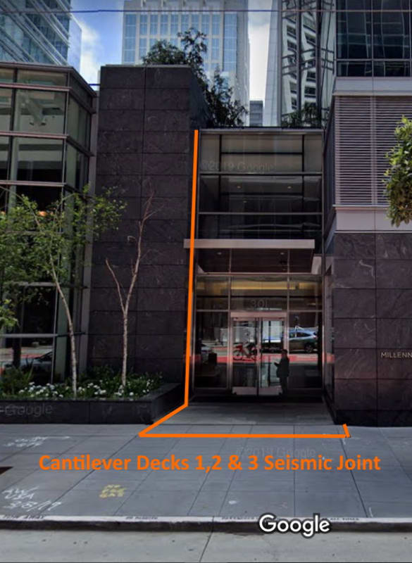

So surely the SGH photos attributed to level B1 must be at level B2. To verify, I first looked at construction photos to see if any showed a wall being built at the B1 level separating the tower & the garage but no luck. But I did see the ground, mechanical and 3rd floors of the tower had decks cantilevering over the podium mid-rise.
I couldn't find any drawings that suggest the tower's cantilevered decks connect to the podium. The result, are offset seismic joints between the B2 level & the ground floor.
Here, (Google Maps) you can see the 3rd floor (pool deck) is supported by steel beams connected to a separate structure from the tower's cantilevered deck. An elevator shaft can just be seen in the shadows. Photo 11 (page 6) of the SGH Field Report #7 appears to identify this as a shear-wall. But what level, B1 or B2?

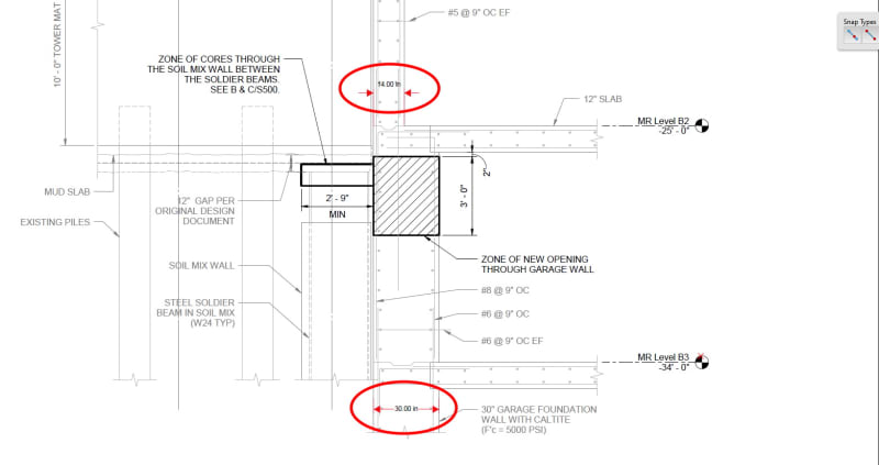

Still trying to rule out any B1 podium level concrete wall I looked at SGH Supplement No. 20 - June 7, 2019. It is a response to the EDRT regarding the prospect of the tower coming to rest on the tower/podium shoring wall. On page 9 of the document is a cross section of the tower:podium interface. Assuming this is the case over the entire length of the B1 podium/mid-rise basement adjacent to the B1 tower basement. There isn't any B1 West Basement wall built of shotcrete that is cracked and leaking.
None the less SGH sure seems to think one exists.

I reached out to Dr. Robert Pyke who had asked about the impact of the garage shoring wall on the design team's estimates of future settlements in one of a series of letters From Dr. Pyke to Neville Pereira of DBI. I guess he was concerned that when the EDRT asked about the shoring wall in 2019, they got the usual runaround from Hamburger and Co. This is what Pereira wrote back to him: As you noted in your letter, the EDRT has previously raised a comment with the design team regarding the existing CDSM shoring wall beneath the east side of the mat foundation. As part of our ongoing review, we are confirming with the design team that the possible effects of the shoring wall are being addressed in the analyses to evaluate building settlement and the mat integrity for the proposed revisions to foundation retrofit. This suggests that the DBI and the EDRT had been asleep at the wheel since 2019. Dr. Pyke has not yet received any further response from Mr. Pereira.

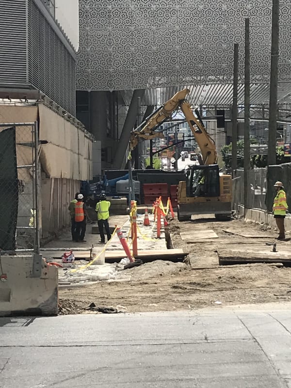

Photo of Fremont St sidewalk as of yesterday. Serious digging has not yet started.
