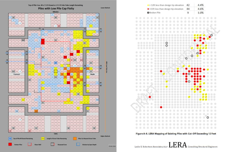

I was going through LERA's "301 Mission St. Stabilization - Structural Basis for Design" - Sep. 20, 2018, compliments of Larry Karp's Millennium Debacle page and came across a disturbing bit of information. Beginning on page 106, LERA gives the "As Built" description of the existing piles.
The piles Do Not conform to the Shop Drawings and description provided by Simpson, Gumptertz & Heger's, "Supplemental Report for Foundation Settlement Investigation"
How does this even pass the muster of the 301 Mission St. Dearly Departed Mayor Edwin Lee's Structural Safety Review Team? It seems that the entire report to the City of San Francisco was based on DeSimone Consulting Engineer's Design Drawings and NOT on what was actually built. San Francisco paid $150,000 for the report and seems to have been hoodwinked. Where was Craig Shields, the Geotechnical member of the Structural Safety Review Team?
Surely, if anyone had access to the As-Built drawings and RFI log, one would think it would be the Developer and their post-construction engineering team. There doesn't seem to be any comparison between the superiority of LERA's "Initial Work" and what SGH has served up. The HOA has made some very poor decisions.
Further into LERA's section on the existing piling, they produce a graphic that shows the locations of the short driven piles; not too different from the one I produced from the shop drawings. It would be interesting to know how Engeo Geotechnical Engineers described the ground and it's effect on the piles.
While I don't know when in 2018 LERA developed their 'short-driven' pile map. I'm going to gloat a little for having posted mine to Eng-Tips in early April of 2018, while their report is from Sep. 2018.

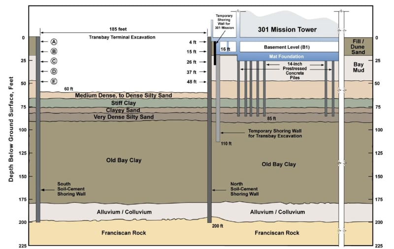

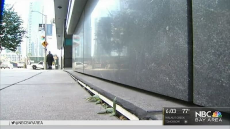

A recent report by NBC Bay Area’s Jaxon Vanderbeken has been getting some traction in the press. NBC’s report brings to the fore, the tower/podium shoring wall and the fact that the tower will most likely come to rest on the CDSM wall.
SF Gate later ran the story with commentary from SGH’s Ron Hamburger. Hamburger seeks to give assurances regarding the shoring wall, stating they have been aware of the shoring wall since 2014. No doubt this is true but more so, in relation to the leaking in the 5-level parking structure. It was, after all, LERA/Enego who felt it necessary to investigate the relationship between the tower and the shoring wall.
Compared to LERA’s permit submittal of just two locations of investigation, the actual scope of work was far more comprehensive. Still, it appears LERA missed the portion of the shoring wall that would have revealed just how much distance remains between the Tower/Podium shoring wall and the bottom of the 10ft mat foundation.
In SGH’s original 52 pile retrofit scheme, the Expert Design Review Team’s 2019 Final Comment Log, Comment 20, indicated the separation between the bottom of the mat foundation and the top of the shoring wall, noted by LERA/Enego, was approximately 2 inches. Considering the locations where LERA/Enego/ Nicholson Construction/Cotton-Shires Assoc., cored through the parking garage wall, to inspect the shoring wall/tower separation, there is no clear knowledge that the northern end of the shoring wall, at Mission Street, isn’t already in contact between the mat and the shoring wall.
While not a perfect analogy, SGH seems to be taking the ‘coaster under the table leg’ view of their repair scheme. What seems more likely is that the tower will settle to the east and come to rest on the northern stretch of the shoring wall before any settlement to the south can make any meaningful difference.
Since the tower’s foundation was mechanically connected to the shoring wall during the tower’s construction and it didn’t show any signs of settlement; SGH seems very optimistic that the shoring wall will indeed settle.
From the 13th floor to the 42nd floor, 56% of the building weight was incrementally added to the tower, at approximately 3 million pounds per floor, per week. When the tower was released from the shoring wall, tower settlement accelerated dramatically until the topping off ceremony.
The top of the shoring wall deserves some characterization. The wall has 34 each W24 soldier piles, in total, mostly spaced at 5ft on center. The final 30 feet of shoring wall at the north end has 6 soldier piles, spaced at 2.5ft on center. These soldier piles were subsequently cut down just above the Cement/Soil mixed wall. The tops of these soldier piles will be the first points of contact with the bottom of the foundation. This northern end of the shoring wall, is an area in the adjacent parking, subject to cracked walls and slabs with persistent water ingress. Since the tower won’t be coming to rest uniformly across the entire shoring wall, there is concern the soldier piles will chisel into the bottom of the tower's mat at a subterranean level; known to be well below historical ground water levels. According to ARUP’s Transbay Transit Center geotechnical investigation, the ground water of the former Yerba Buena Cove is brackish.

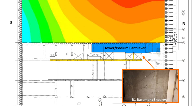

The following image shows the extent of LERA’s shoring wall investigation. The image requires some explanation. The base image provided the breadth of the site, with the shoring wall in yellow and the tower’s ground floor cantilever in blue. LERA’s investigation (Light Blue Overlay) is scaled to the base image shoring wall to highlight the extent of the shoring wall investigated. The lower overlay shows the 10ft mat and the original permit inspection points.

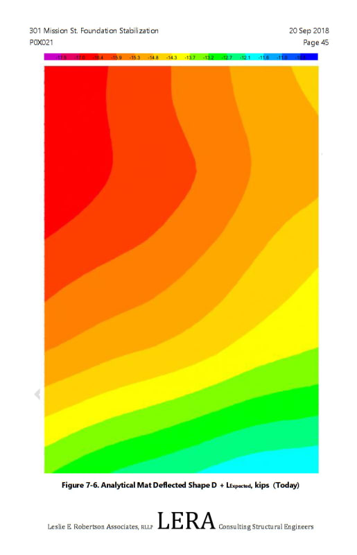

Page 45 of LERA's "301 Mission St. Stabilization - Structural Basis for Design" - Sep. 20, 2018 shows LERA’s Analytical Mat Deflected Shape, as of Sep 2018.
Scaling LERA’s Mat Deflection Map to the Tower/Podium shoring wall, it appears that LERA may have missed the portion of the shoring wall that represents the least separation between the tower’s mat and the tower/podium shoring wall.

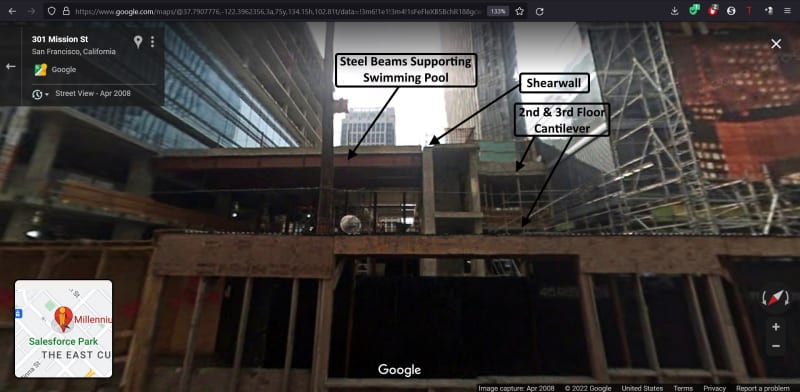

In my April 18 2022 Eng-Tips post, I showed cracks in the Podium’s Elevator Shaft (Level B1) that is integral to the 5-Level Parking Garage’s Shearwall. This is directly in relation to the area missed by LERA’s shoring wall inspection. While pure speculation, what appears to have happened, is the Podium/Garage has suffered Shadow-Effect Down-Drag, resulting in the cracks seen in the elevator shaft.

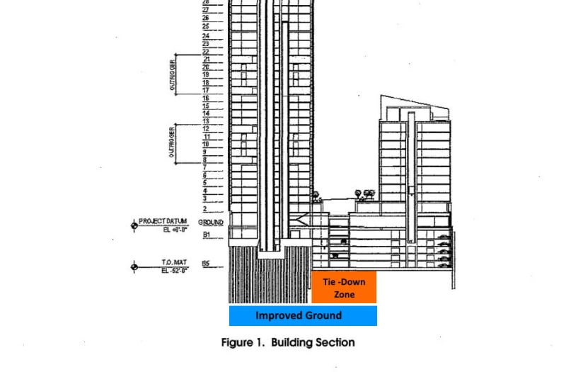

With the tower in its current state of tilt, the tower’s cantilever decks that projects into the podium, should be moving away (West), from the podium’s elevator door opening.

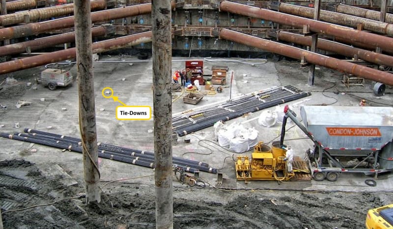

Remember that the Podium is buoyant and the 6ft thick portion of the podium/mid-rise mat, between the tower and the mid-rise is secured to ground with tie-downs.
Perhaps this explains why there appears to be uplift of the Mid-rise at the northeast corner of the Mid-rise at Mission & Beale. So, not so much basal heave as thrusting of the 6ft Mid-rise/Podium Mat.
I don’t recall if the EDRT has concerned themselves with the seismic gap between the cantilever decks and the podium. Or, how much the gap will close as the tower settles to the east.
