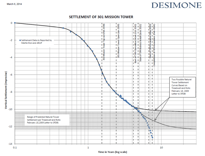

One aspect I've been looking into was construction of the TTC buttress wall re-initiating settlement of the MT. Given the problems SGH has had with installation of the new piles accelerating settlement again, construction of the TTC buttress could be linked as well. The attached Desimone/T&R log scale shows end of primary consolidation may have been approached but resumed after buttress construction. This problem could have been exacerbated by the CDSM shoring wall NOT being complete due to the PGE vault relocation between Fremont/Mission as discussed in the attached ARUP/BF documents. BF/ARUP proceeded with dewatering and ARUP emails show piezometers levels were lowering the groundwater beyond those in the HSI dewatering analysis. I think the big takeaway is everyone who has touched the project underestimated the OBC, especially T&R pushing the OBC back into a normally consolidated state.
Slide #11 is telling... The Tower of Pisa was tilting as it was being constructed... there is some real intesting history there.

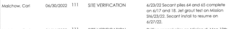

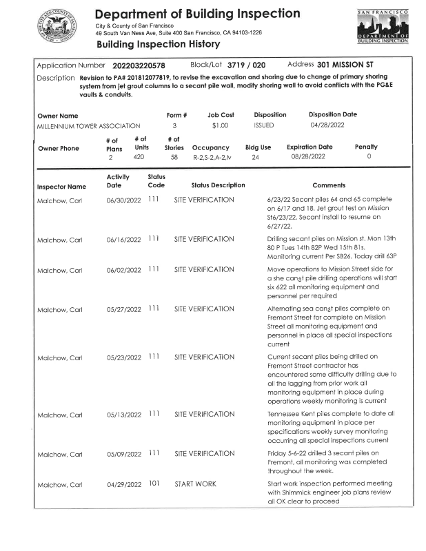

Well, started and then kind of stopped. They have installed every second pile for the secant pile wall(s) along Fremont Street and then switched to Mission Street. It appears that no-one who is willing to speak knows why, but they were approaching the 3-inch limit on westward tilt for the year that the design team had themselves proposed.
Note that the DBI inspection report starts at the bottom of the page and reads up!
Am I missing something here?
The date occurring before the date of the report?
Dik, I don't see a date on the report. It has a disposition (start) date and an expiration date, but the report itself is not dated.
