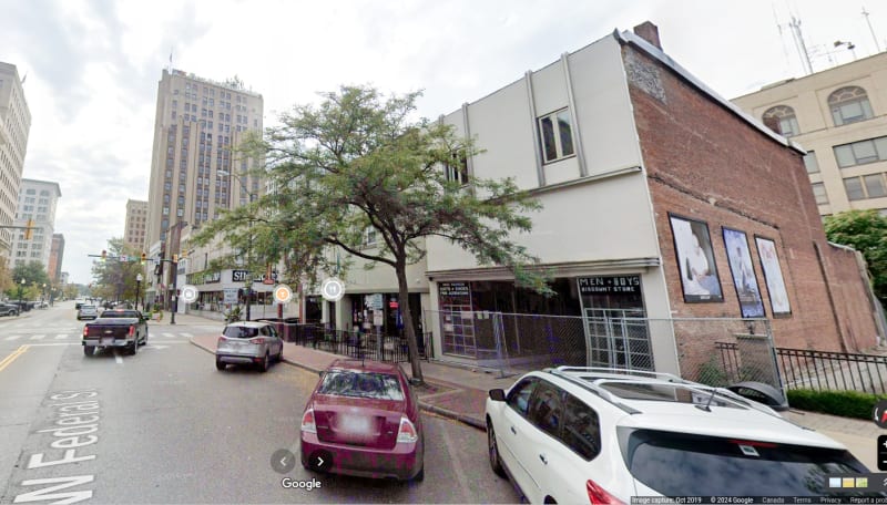

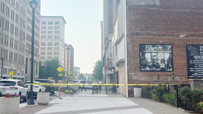

This one is both a failure and success, at the same time. A 100 year old, historic, 12 story, steel frame office building that was converted into apartments. Early reports say that workers who were clearing out old utilities in the basement cut through an abandoned gas service line that was still connected to the gas main (i.e. abandoned in place, capped somewhere in the building, but still very much "live"). The ground floor and basement are massively damaged, obliterated might not be too strong a word, but the structure is apparently stable for now. NTSB are investigating, as apparently gas is their domain because it moves. The engineering of the structure seems to have performed extremely well for such a devastating explosion in the basement.
NTSB: Natural gas explosion at the Realty Tower Building
Google Maps

CBS: Explosion in downtown Youngstown, Ohio, leaves one dead and multiple injured
CBS: Photos show extensive damage caused by explosion in downtown Youngstown, Ohio
