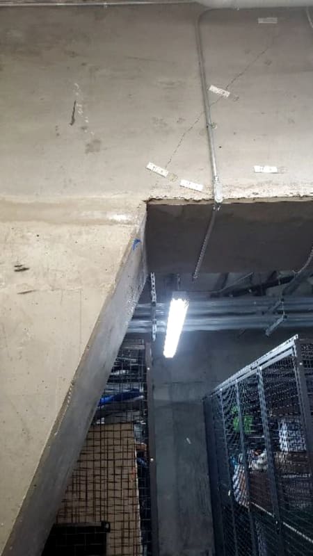

Epoxybot, that is a really scary photo Trying to pour that with everything tied is close to physically impossible even with a great plasticizer mix, that is alot of steel to get the aggregate through. That crack is getting close to the bars and that is not a good thing, because that beam should be not be under enough tension that the diagonal crack suggest.
The reason the concrete looks that way is because there is a ton of water added and it is all "cream" and no "rock". I have poured some pretty big beams with triple #13 top and bottom and the only way that I know to do it is to tie them as you pour.

A little follow-up on the crack in the link beam adjacent to the southeast SMRF. Beams cast to support the driveway tie into the SMRF/Link beam/s. It would seem the driveway support beams are pushing on the SMRF/Link-Beams. This took place before the tower was given a Cert. of Final Completion.
In the photo that epoxybot posted there appears to be at least 3/4" of conduit running thru deck / beam connection. Does anyone know what deck system they used? I'am starting to think that this building has incurable problems that would not matter if were constructed on s correct foundation.
I just read an article of the google, that suggested that they are going to just start excavating in preperation for the mat extentsion without approval for the reduction from 56 piles to 18. I have never seen the bottom of a mat foundation exposed, and the thought scares the poop out of me, that is one major rain event to a nightmare.
I'm having trouble seeing any hint of conduit running thru deck / beam connection.

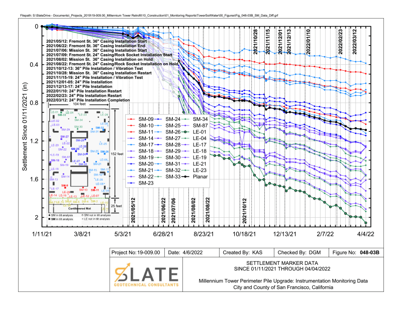

The latest report from the tilt-o-meter is strangely late. Wonder what's up.
I didn't see any either, I thought I had just missed it, glad you didn't see it either! I was also wondering about the tilt report, hopefully it's nothing unusual but being late you certainly have to wonder.

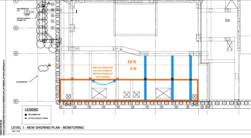

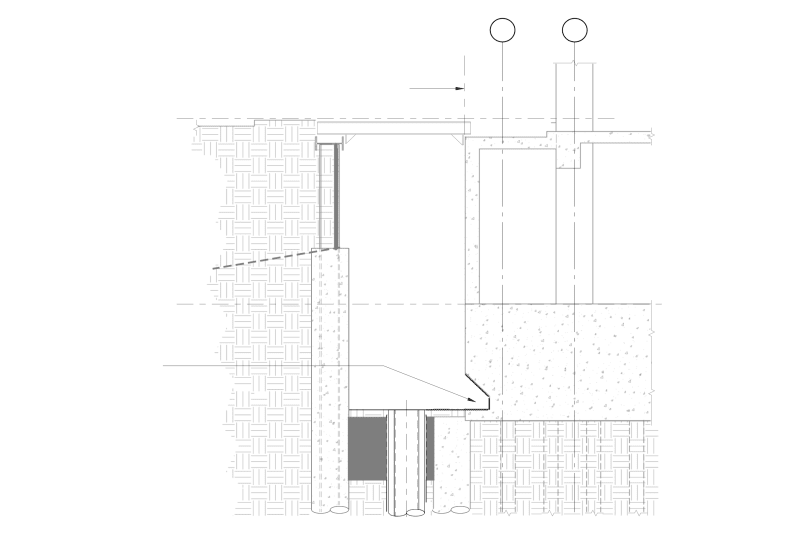

Keith 1 - they are not actually going to excavate under the bottom of the mat. Just down to it. And then jackhammer a hole in the mat, which I think knocks off the tops of the first row of the existing concrete pile, in which they then pour a key. This is shown in Step 7 of their drawings.
What the drawing does not show is that they are now down in the young Bay Mud, which would heave at the bottom of a 25-foot excavation even if there were not a 600-feet-tall building right next to it. Who knows what will happen in this case?

And meanwhile, it's been two weeks since the last posting on the tilt-o-meter.
Sure hope it ain't broke.

I am pleased to report that the tilt-o-meter is still in working order, though it's running a bit behind. The April 6 report was just posted.
I am also pleased to report that the rate of tilt change is roughly the same as it's been, and the Salesforce Tower continues to be in peril.

I think the tilt-o-meter has been drinking. Very weird results. The next week's must be even worse since they are late again?
If I'm not mistaken no work has been going on recently but yet a couple of the test points went up? Certainly makes me question the validity of the measurements.
