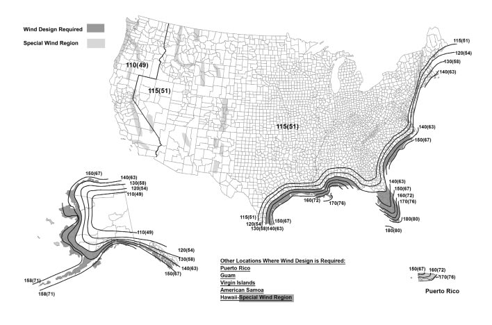

Hi everyone i have a question regarding a single family home two stories bracing. Is it acceptable to mix bracing methods (let in bracing and structural sheathing) in the same braced wall ? I.e at the corner you have sheathing and after down the wall line you have several let in bracing ? Alt wind speed is 150 mph 140 MPH (edited typo) Thank you.
At 150mph you can't use braced wall design at all.
International Residential Code said:
The wind provisions of this code shall not apply to the design of buildings where wind design is required in accordance with Figure R301.2.1.1, or where the ultimate design wind speed, Vult, in Figure R301.2(2) equals or exceeds 140 miles per hour (225 kph) in a special wind region.
It needs to be designed using engineering principles - shear walls, diaphragms, etc.
Sorry edited typo. 140 MPH.
Doesn't change the fact that, unless this house is in Nantucket, it has to be engineered. 140mph still "equals or exceeds 140 miles per hour."

That says "in special wind regions" so if they aren't in a special wind region it's possible. Y'all got to read the whole sentence.
And you need to read that section of the code that provides a picture showing every place in the country with wind speeds of 140mph or greater that isn't Nantucket (so, Texas to North Carolina along the coast) as a special wind region requiring wind design. Which is why I added the caveat for Nantucket.
(For total clarity, I'm just using Nantucket as a placeholder the southern shore of Massachusetts.)

Nor do they need to. The IRC figure is pretty clear that wind design will be required, unless they're in Massachusetts. Though even that might need it, too...the resolution on the image isn't great, and those islands are mighty small...
AETX said:
The question is that i have seen it being built and was just questioning if it is acceptable to mix and match of sheathing and let in bracing in the same wall line
When using the braced wall provisions of the IRC (correctly), it depends. Check out R602.10.4.1 Mixing methods for the rules on mixing types of bracing. But, again, there's nowhere in Texas that you could use IRC braced wall methods with a wind speed of 140mph or greater. And, actually, that map makes it look like they include 130mph along the Gulf and south Atlantic coasts.
Whil I get the idea of looking at the "base" IRC for a general question, first, the figure doesn't match the text, unless they've added a BUNCH of special wind regions recently. SWRs tend to be out West or in the mountainous bits of the Appalachians, not the coast.
