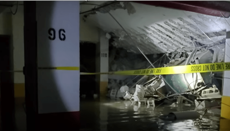

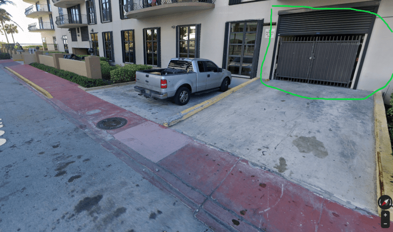

Demented, we've contemplated where they may have stored the large tar kettle at night... someone earlier that he'd seen them stored inside condo garages even.
Could it be stored and locked behind this utility gate? And where does that lead to? Is it a room on the 1st floor or does it go into a garage storage area? On the plans it looks to be called a Transfer Vault? It doesn't make sense they'd have those gates at the end of the lobby hallway. The window in front of that truck is the Kitchen off of the Rec Room.
I think there was a fire in this area.

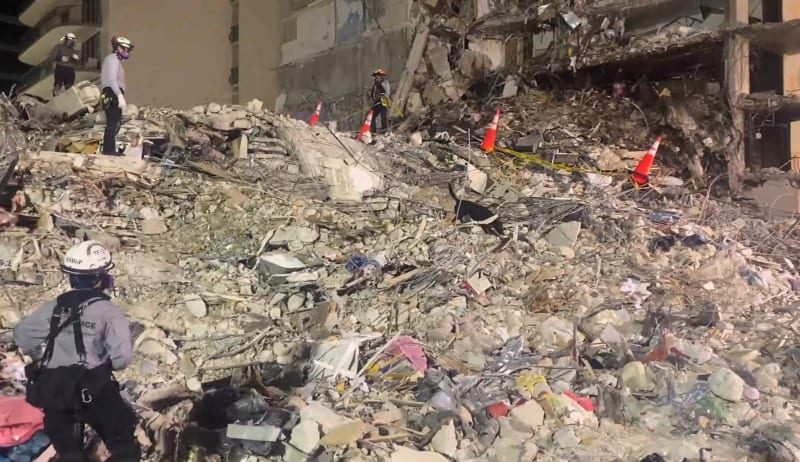

Why do some engineers want to look at objects in photos? The answer is that a trigger for the collapse has not yet been found, and the engineers looking at photos believe that they can see what triggered the collapse. This does not imply a conspiracy on the part of these engineers. They are merely trying to help determine the cause of the collapse, just like the many structural engineers who believe they already know the cause of the collapse. In fact, one might wonder if there is a conspiracy on the part of some engineers to avoid considering any cause of the collapse that might place the blame on their specific profession’s responsibilities in the collapse.
If one cannot find a trigger for the collapse, then one can never know whether the true cause of the collapse has been found. This leaves the public with a very uneasy feeling about building security. For example, Morabito Consultants’ report warned that Champlain Tower South was structurally deficient, citing spalling with exposed rebar in the pool area, spalling on the balconies, spalling on the drive ramp, and water collection in the parking area and on the pool deck. Yet, the pool area still remains standing today without losing a drop of water after everything else has collapsed, the drive ramp has never collapsed on its own, no balcony has ever fallen on its own, and drains were put into the pool deck ten years ago. The water in the basement parking area was a real concern of all building residents, but it was never addressed how this problem would be fixed. Instead, a large part of the Morabito proposal was involved with non-structural improvements, like installing roof anchors, repairing stucco, repainting, replacing air conditioners, and improving planters at the building entrance. It almost seems to the public like the Morabito report was using mild structural problems as a way to scare the residents into paying a larger sum for what is essentially cosmetic repairs.
When the public hears about how structures are compromised by water causing spalling, they wonder why the Champlain Tower East hasn’t collapsed when spalling in one of its basement columns was far worse than the spalling seen on any column in the Champlain Tower South parking basement. When the public hears about how structures are compromised by water pooling in the basement garage, they wonder why the Marriott Inn Surfside hasn’t collapsed when it had several feet of water in its basement garage, yet the Champlain South building collapsed when it had only a few inches of water in its basement garage. Since these other buildings are still standing when their structural problems appear to be far worse than those of Champlain Tower South, the public gets an uneasy feeling about not only whether the true cause of the collapse has been found, but whether structural engineers truly understand why buildings collapse.
Somehow we must reassure the public that structural engineers know how to design buildings that do not collapse, that foundation engineers know how to control water intrusion into basements, that construction companies are held to rigid standards that avoid collapse, that inspectors are honest and knowledgeable about the building specifications, and that building maintenance personnel adhere to the original design specifications. One way to reassure the public that this process is being followed is to find the trigger for this building’s collapse. Another way is to strengthen regulations when they are insufficient. One thing that comes to mind is a regulation about certifying the building’s foundations relative to water ingress. Another might be to identify the person responsible for controlling roof loading during maintenance work, deck loading to prevent adding sand and paving tiles without removing the original tiles, and floor loading during condo unit improvements. Another regulation might be to demand x-raying when taking cores at regular intervals or when drilling into the cement structure to install objects like roof anchors to avoid damaging the rebar. Yet another regulation might be to inspect roofs and decks after a heavy rain to determine if water is removed promptly and thoroughly.

Optical98, The service drive is directly behind the area you circled in green. Once in that area to the immediate right or corner location appears to be the electrical transformer vault feeding power to the building.... Not a Transfer Vault.
Edit: All of that is on first level, not garage level. I imagine the transformers are still filled with flammable liquids???

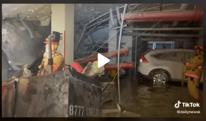

And right below that area we see it partially dropped into the parking garage... and we can see the trash containers that were probably housed behind the service gates, ready to wheel out on collection days.
And large pipes that used to connect to the Generator room, seen broken.
As-built it was almost certainly an oil filled / oil cooled transformer. On one of either the site or basement plans, there's a subterranean oil tank for it below / near the transformer vault. I could be wrong, but I think it's below the basement slab, and there was an access manhole somewhere outside the building.
The vent on the solid wall to the right (west) of the service entrance is for the transformer vault.
It is roughly where the stubborn post-collapse fire was. Transformer oil could have been fuel for that, but that's pure speculation.
Yes, that's roughly at the inner end of the service corridor / dock. The surviving columns, where the slab has only dropped about a foot are D2 and D5. Hidden in the collapse, not far into it are E2 and E4 (E5 does not exist). If you catch the longer video showing firefighters drilling there, you can positively identify the location from the unusual double column on the left at the start of the video. That's A2 & B2, if memory serves.
