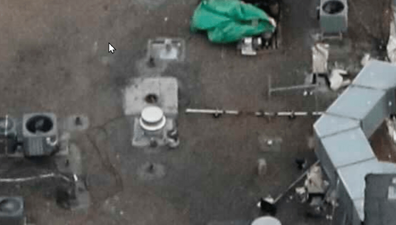

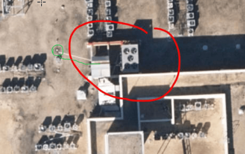

Have we any indication of where this cable in the steel support permit denial is, and if it did have a turnbuckle attached? Where would this cable have been anchored?
Edit: Ha, nope.
Demented, a cable attached to the AC unit? I know I saw a picture that showed a bit of it, and later a hole where I assumed it was yanked out. I'll try to find it.
Seems that was the plan for the denied permit. Was it just held down via tensioned cables anchored to the building? Maybe thats what the tearout on the remaining beam atop the column we see in the controlled demolition. The thing from the other side in the drove video we know had no rebar in it. Plus that field report. That would be an ooopsie. A lot of oopsies.
This pic is before the new unit, but I think u can still see it on the new set-up too.

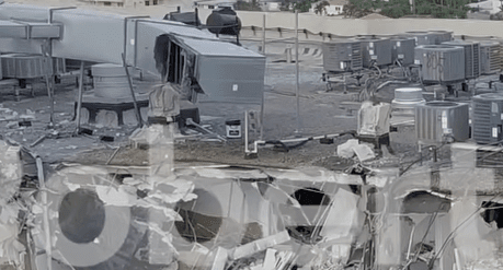

That would appear to be a PVC drain. It's more visible in the 4k drone video.
This is the hole after, yeah potato pics...I can't tell cable from pvc....

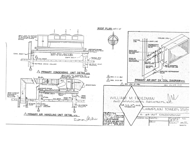

I find this photo interesting, in that there is no concrete beam at Penthouse Corridor like there is shown on original Plans, and even on revised original plans. This Penthouse Addition was changing on the fly, IMO.... Originally there were 2 concrete beams spanning columns at each end. 2019 Photo shows one end of platform hanging off West CMU Penthouse corridor wall.
Could their 'Value Engineering' have eliminated the 2nd concrete beam, by just hanging off CMU wall? Photo as-built does not match any version of original design I could find.....
Edit notice column line on left of hanging AC supports
Here is one version of AC support beams, and I will look for plan that has revised 1980 date too.

#Demented, And failure on West side AC area would be hidden by East Penthouse Corridor Wall in the Security Cam video.
Edit, Slab could have failed under CMU West penthouse wall, well before columns actually failed with AC load on CMU wall and not column line

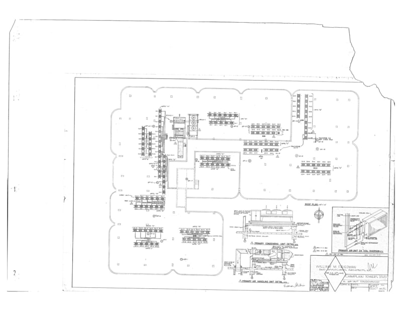

Notice Revision 1 and 2 from Oct 31, 1980 and Nov 11, 1980.... Very fluid changing design, and perhaps pressure to get done ASAP... Sorry this is AC4 I posted. You can find it in several of Surfside PDF's both with the revision dates above
@Optical98
That hole is the trash chute vent. 5/14/80 Rev date Penthouse addition plans. SHT 4 of 9
Why extra steel beam on top of steel beams sitting on concrete beam on one end, and hanging on CMU wall on other end?
Was extra top steel beam, a bandaid fix for failing concrete beam in 2009?
