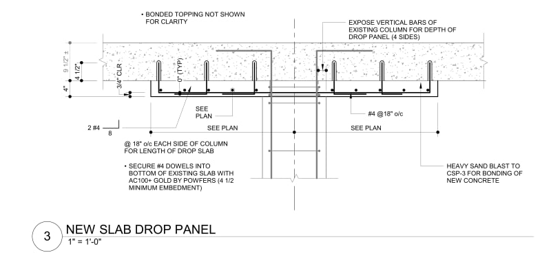

this is the detail in the Morabito rehab plans that shows strengthening of the slab to resist punching shear. These are preliminary plans so they don't say where they intended to use this but it looks like they didn't think some of the 9-1/2" slabs were adequate to resist the design loads for this failure mode.
I think you bring up a good point here. There's not really a code rationale for a structural engineer to 'strengthen' the shear capacity of an existing slab/column interface unless the design loads were being changed or the existing capacity was insufficient for the applied loads. Based on the core samples taken it appears as though the deck was a good bit thicker than predicted. I'd imagine their engineer elected to add in drop down panels to accommodate the existing loads.
Another thing that I'm a bit skeptical of are the planters. I might be missing it, but on my drawings I traditionally call out planters and their estimated weight of soil, etc. For really large planters on buildings, Ive put a line in there limiting the kind of plants they put in the planters. I dont really see that on the original plans.
