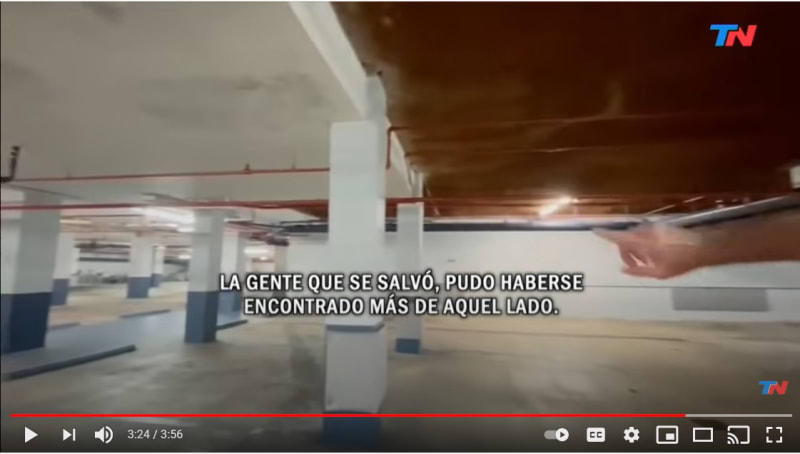

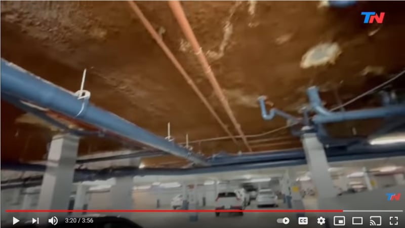

One thing I noticed in the video of the North Tower is the condition of the ceiling in the garage. One part looks moldy and discolored while the other part is nice and clean. I assume the clean part is under the building itself, and the other is under the pool deck and patio area where water is getting through the concrete from above. Is there any other plausible explanation?

The higher dark ceiling is under the living space and is coated with additional material. The pool deck level is 1'-6" lower and uncoated. The exterior parking and entrance drive is a third intermediate level.
So I got it backwards. What we see is the deterioration of the added coating on the underside of the slab under the living spaces. That makes sense, and it's not as alarming as I thought. Thanks for the correction!!
The subtitles in the video are more accurate than the auto generated ones. This is a quick and dirty as many who don't understand Spanish may find the video more interesting with a better translation.
00:21 Estamos en el edificio gemelo, pero aquí

03:19 La gente que se salvó, pudo haberse encontrado
[The people that save themselves, could have been]
03:23 más de aquel lado.
[more towards that side.]

03:30 Pero este edificio parecería estar
[But this building would seem to be]
03:31 mejor mantenido de lo que
[better maintained that what]
03:33 mostraron en el otro edificio.
[what was shown of the other building.]

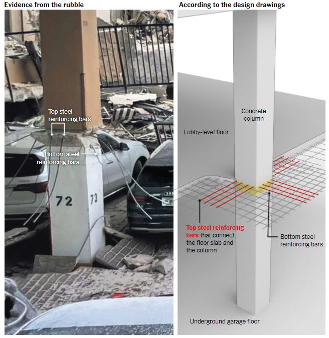

Please help an electrical to understand here. Do I understand the deck, which appears to be no thicker where it meets the columns, is reinforced by 12 X 12 pieces of steel that don't seem to be much bigger than the columns they sit on?

See related DWG's that I could find for the SOUTH [not north] Towers
S.6 Second Floor Framing Plan (Pg.28 of 336) & (Pg.110 of 336)
Typical Notes
#5 at least 25% of all column strip reinf. shall be centered over the column as explained in typ. flat plate det. - see sheet S.11
S.11 Flat plate Sections and Details (Pg.38 of 336) & (Pg. 237 of 336)
S.5 Lobby Level Framing Plan
(Pg.31 of 336) & (Pg. 162 of 336) & (Pg. 210 of 336) & (Pg. 234 of 336)
