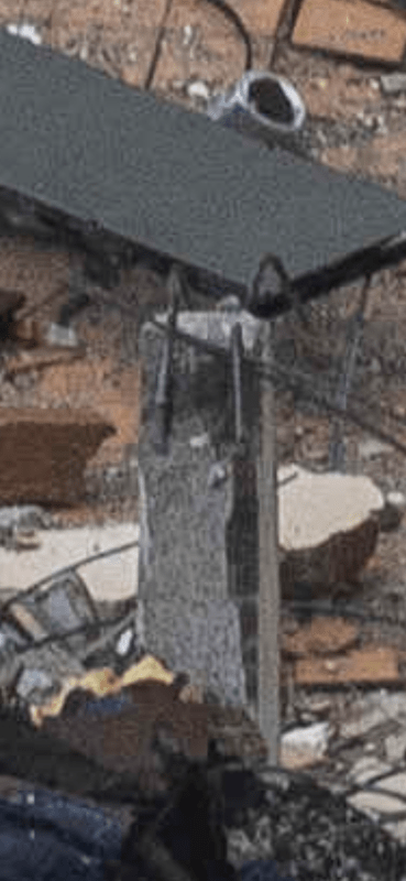

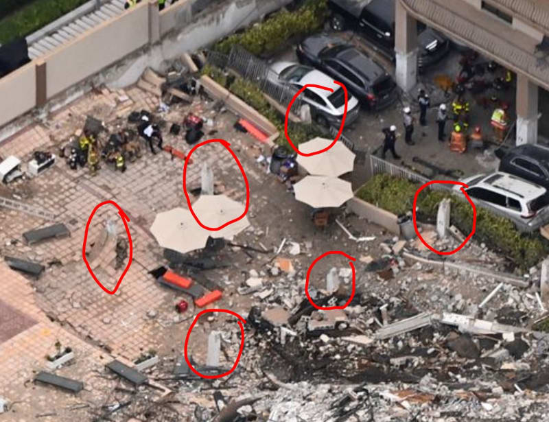

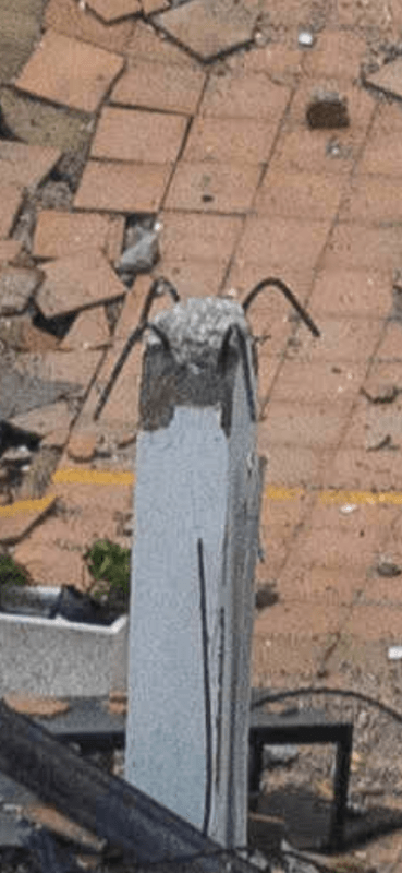

Its interesting to see that the columns punched through the slab and what is left of them look like half sharpened pencils. Punching shear theory assumes that the crack will form at the face of the column and radiate at a 45deg angle up and out, leaving an upside down cone shaped piece of slab atop the column. This did not appear to happen as it looks like the slab took some of the column concrete with it on the way down instead.

Awestruc (Structural)6 Jul 21 23:56 Its interesting to see that the columns punched through the slab said:
and it looks like the slab took some of the column concrete with it on the way down
I would suspect weak concrete, demonstrating a failure in compression rather than diagonal tension.
Or perhaps simply crumbling.
I hope they investigate the quality of concrete in the slab and columns and compare the findings in the pool deck/courtyard with that in the building areas.

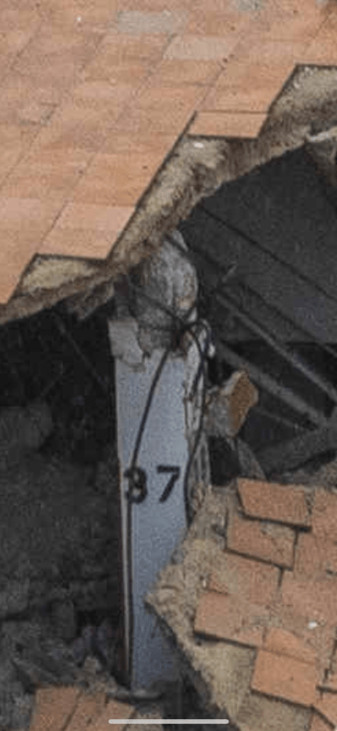

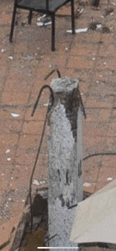

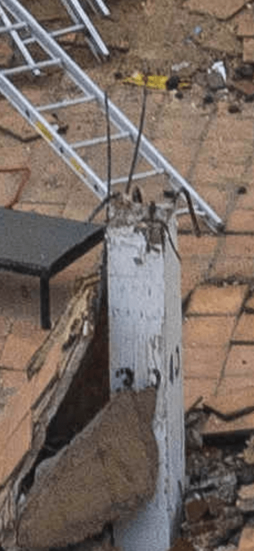

Awestruc, details of some of the column tops:
The middle part of the building's history is not considered. Major 2002-2003 work by A.T. Designs had a bunch of structural repairs, mostly balconies. Then again they were doing more repairs 2009. Column spall repair pg.172 chipping out concrete at columns was part of it and who knows if they did more bad than good. I'm not sure what stacks 01,02,03,04,12,14 and poolside 09,10,11 mean but they worked on those as well. pg. 17/218 many observations.

Thanks for the close ups Spartan5.
The brownish slab concrete definitely looks badly deteriorated compared to the Grey column concrete.

Looking at the column photos, the pool deck patio slab looks to have failed in negative moment bending.
