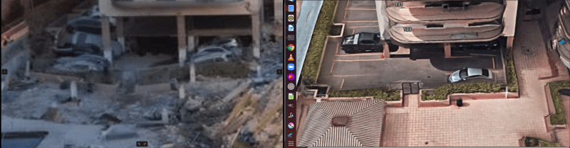

I keep being struck by the collapse of the above ground parking area.
The slab at that point changes from being attached to the main building columns to the parking garage columns, which are at a wider spacing than the building columns.
ON top of that you have some big heavy planters. This looks like a good place for the initial collapse to start as there is a gap in the planters for access.
Does anyone have an original plan for the top parking area for that surface parking? That's where your bigger heavier vehicles comes into play as well.

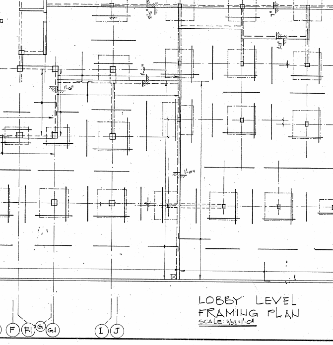

In the big 1979 plans PDF, page 3 shows the spaces on the site plan, or page 15 on the landscaping plan. The basement and lobby/first framing plans give the structural details, I think. It's the same 8 spaces on the collapsed area. Planters are pretty much the same, from a quick glance. The south side is mostly constrained by columns being at 2 car widths, so spacing can't really have changed over the years.
It's certainly something to look at, if the structural design for it was for up to 4000 lb cars, and someone has been driving a 10000 lb construction / service truck on it (for example). It has limited height, but it's still a plausible scenario to look at with the construction activities that were ongoing.

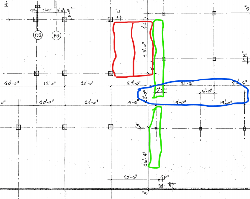

OK, those plans make interesting reading.
The bit that I'm looking at is the change in column spacing and size from the columns under the building to the pool area.
The spacing changes from 23 feet in a NS direction to 29 feet and smaller columns. The rest of the patio deck is 19 feet spacing and all you have on top is scattered people, not 2-3 tonnes of motor vehicle.
At the same time the EW spacing changes from 20 ft to 23 feet.
Then critically and only in this location, the pool deck is being used as a car park with added planters located over them.
So below the car park spaces on the ground level are in red and the planters are in green.
So is this enough to make this (the blue bit) the most highly stressed bit of pool deck and hence most likely to fail first?
There i one drawing showing a beam which looks to be in that location but no evidence in the collapse photos.

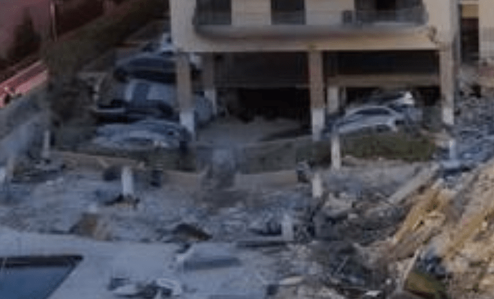

Looking at the photos from Littleinch post of 1 Jul 21 08:39 there may be a design shortcoming in the apron ground floor slab.
Outside it is where the swimming pool is located. Nearer to the building it is the parking area just outside the building at the ground floor. The pool side section had almost no load except swimmers using the pool. The parking section has to take the vehicular load.
The majority of this ground floor apron slab seems to have fallen bodily onto the first floor below ground. That may be due to the debris of the collapsed building forcing the whole slab to sink as a consequential effect as the pool section had no reason to deflect on its own with little or no live load.
The alarming feature is the slab failed at almost every column position by punching shear as though there was no structural connection between the columns and the slab. This is certainly the impression I got from the larger columns that are still supporting the building. The pool portion of the slab might have the connection structurally broken off at the top. Thus the slab was relatively strong in design but its connections with the columns appearto be structurally substandard to fail in this manner.
Here is a comparison between before and after the collapse. "Before" is from the current Google Map. The white paint on the columns I believe signifies the lower level.

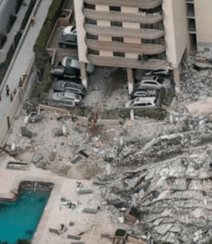

An earlier photo in the Part I of this thread
Shows the pool area slab has partly sunk relatively to the pool which appears to be relatively stable with water still inside. Thus the weight of the pool triggering the collapse will need new evidence able to explain the above photo. Remember the same slab outside the pool has sunk more but it has virtually no live load.
The pool is actually supported by 21 piles and has full height exterior concrete walls. It was not adding any weight to the nearby structure, but contrarily, it was providing support to the column-slab connections in close proximity.
I don't believe anyone here has theorized that the weight of the swimming pool itself had anything to do with anything. The pool reached the foundation so that it's standing is not a surprise. Perhaps you meant the deck?
