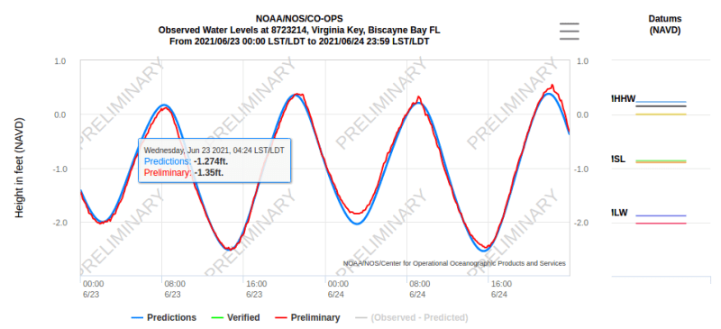

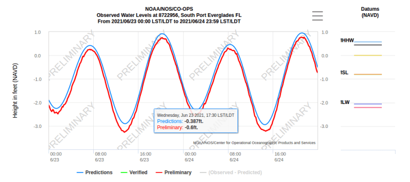

Since no one has posted it yet, actual tides vs predicted tides from charts can be approximated from NOAA tide stations "South Port Everglades", FL "Virginia Key, Biscayne Bay, FL". Sunnyside is halfway between these.
June 24 1:30 a.m (I think this is the approximate time of the collapse.)
At both tide gauges the tide was falling, and not that far from low tide.
This is another data point, that might have some impact on the stresses in the building as close to the shore water pressure in the ground changes with tide? I am not going to guess if the change of support from tidal action has any impact on the event.
I plotted these using local Miami time, and NAVD88 elevations. The drawings precede NAVD88, so they likely use a different elevation datum.
Reference Station Home Pages, look for Available Products>Water levels

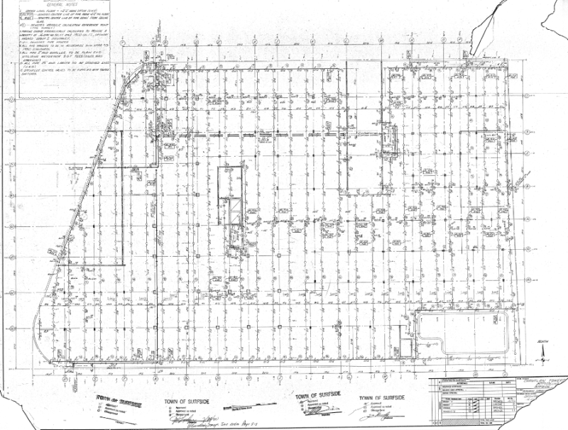

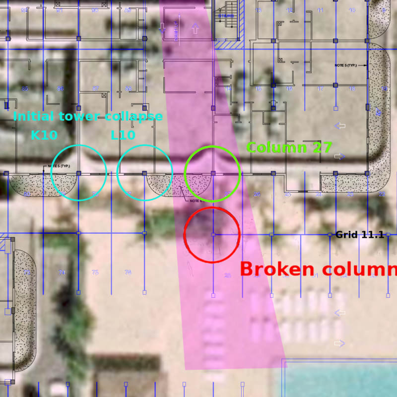

Drawing from ROLL 1-0005 details this sprinkler layout in the basement parking.

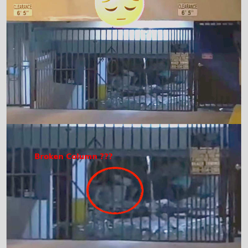

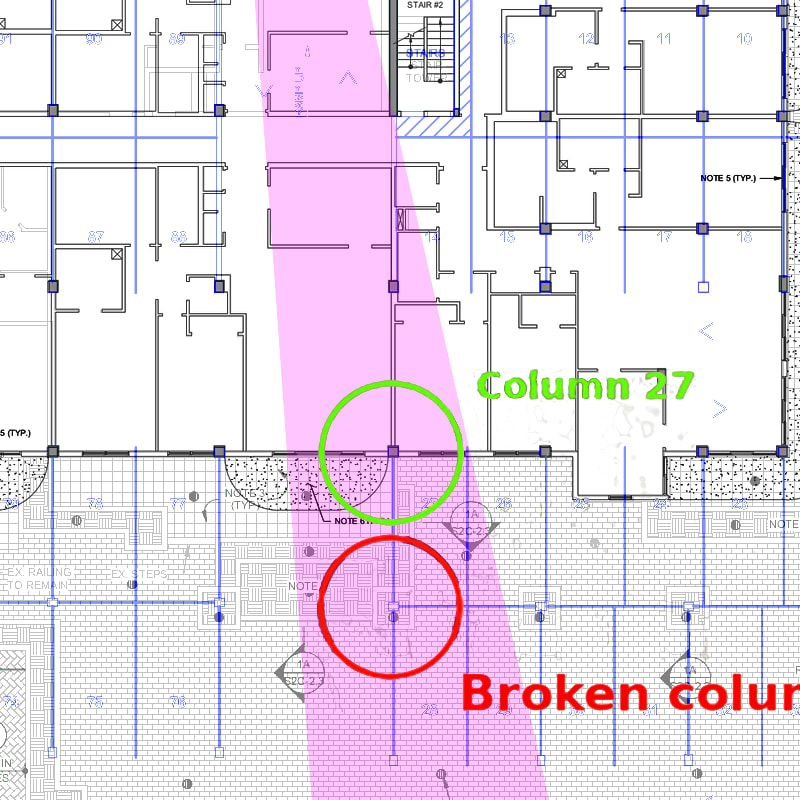

I've reconsidered the Google Earth overlays posted earlier since the parallax was more problematic than anticipated. I'm posting a GIMP file of several layers that superimposes three layouts (Garage, Lobby, Typical Floor) from the city documents over a Google Earth layer skewed to match the property lines of the drawings (I still have to identify the unit numbers with better certainty, thus they aren't labelled).
The following image is what falls out. It identifies the potentially broken column as one that supports a planter outside of the building footprint.
From earlier:
It's not clear whether these planters were original or a refit.
This does not suggest an alternate initiation opposed to the work that warrenslo did earlier, rather it just explores what the TikTok video reveals. I believe it supports the theory that the pool deck collapsed several minutes prior to the main event and shows the extent of this precipitating event. As others have stated, the deck collapse likely triggered fire alarms, and would explain the quick arrival of the fire department.
I believe there WERE sprinklers in the garage, and that they show in a photo posted by Engr1888 at 3:04 on June 27 in the now-closed first part of this topic.

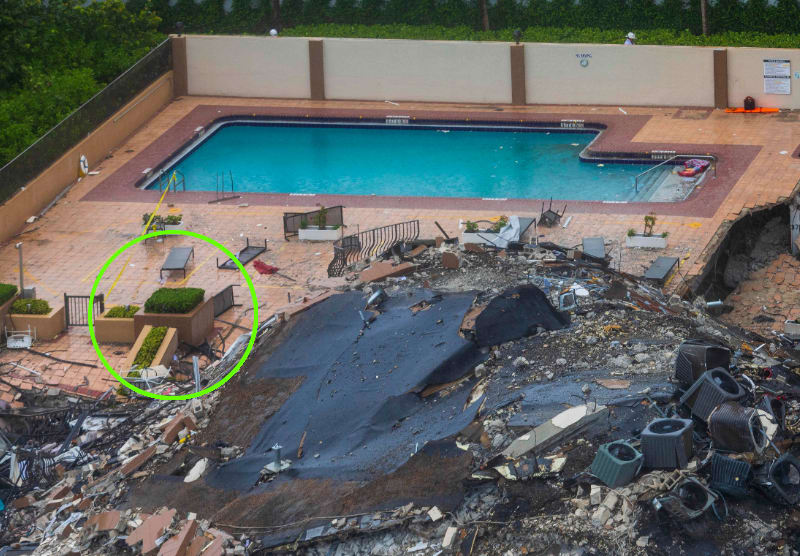

If the planters had drainage issues, it's possible that they rotted the columns upon which the sat. OUCH!

Using an aerial from 2005, the proximity of columns K10 and L10 (identified by warrenslo earlier) to "column 27" visible in the TikTok video is telling. Planters sit atop most of the columns along grid 11.1 and this arrangement has been in effect for some time.
Parking stall 78, which is adjacent K10, was reported to have standing water issues.
So here's my latest story/hypothesis:
The slab and beams on the building side of the planter columns failed in shear due to hidden deterioration. Concrete beams on either side of the planters, framed into/near the building columns started putting more moment on the building columns causing cracking and noise that was experienced by rooms 111 and 611. In addition, the loss of back span put more moment on the adjacent plaza slab span which yielded in moment until suddenly failing the slab to column connection in shear. This sudden failure then quickly overloaded the columns adjacent to the 29 ft span next to the pool. Then somehow this failure causes the failure of the building columns maybe a minute after the plaza slab failure.
