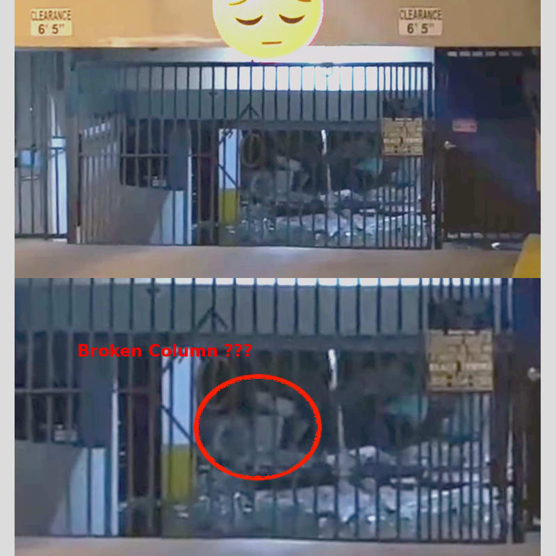

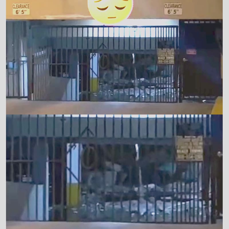

This is interesting. Video of deck failure visible through the north parking entrance. All prior to the full on building collapse.
I don't use TikTok. Ask him/her when this video was taken and if there is any other video.
I am wondering about the source for the dripping water, among other things.

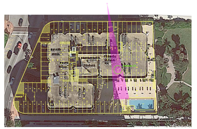

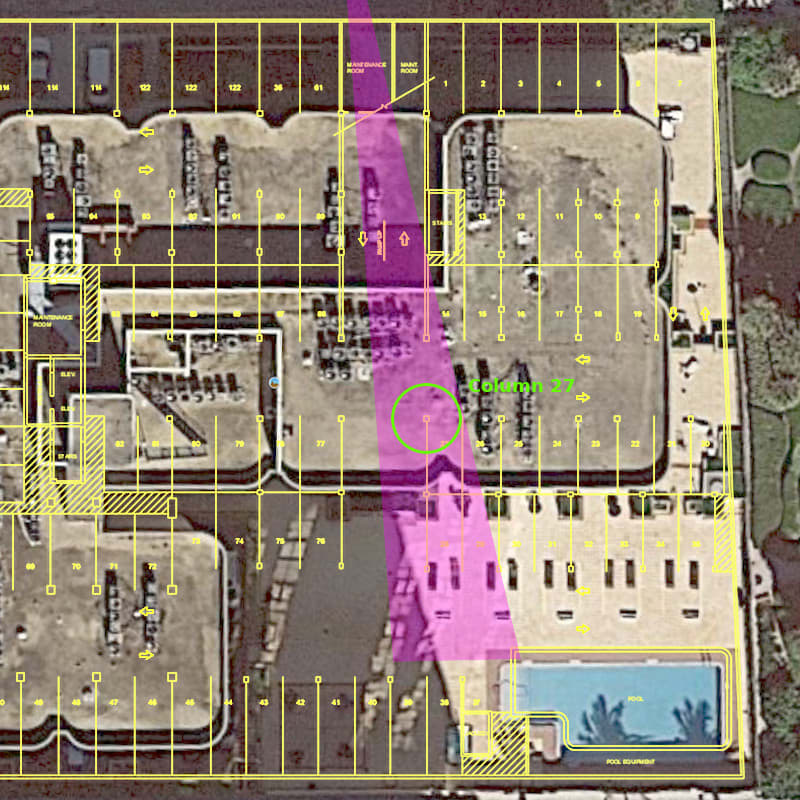

TikTok frame enhancement and perspective:
The parallax shifts made these overlays difficult, that is to say that they were a good start but I didn't do a good enough job. Please see my later posts for better alignment where it really matters.

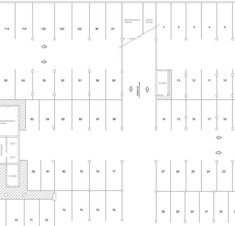

Sym P. Ie, don't those numbers painted on the columns indicate parking stalls? Number visible looks like 27 (or 77?). Which would place damage further in, or to the west, at time of shot.
The TikTok video was taken by Adriana Castillero, who was staying in the hotel next door. They were by the pool. You can see on google the hotel pool has a direct view of the North face of the collapsed wing and garage.
Her husband Roberto Castillero was interviewed by the local media. You can see the interview here. He describes seeing a collapse in the garage.
Multiple enlightening interviews of the unit 111 tenant, Sara Nir, have just been released (we've heard from the son the morning of the collapse, but the mom was the one who saw the upper parking deck collapse in real time from the lobby. It's odd how she describes how the noises were coming from above. It seems unlikely given all the known details so far, but who knows.
Highly recommended:
From the drawings, the debris seen in the tiktok video would be either immediately below her unit or just outside her unit in the patio/pool deck. Others here have been trying to sort this out by counting columns but it seems inconclusive thus far? There was no mention of her floor collapsing, which I imagine her son and daughter who stayed behind for a bit would have commented on.
One of the problematic planters and the first failed columns were all near unit 111.
Yes they do and I was perhaps a little hasty in not better identifying the column. A crop of the parkade map from the posted documentation may be more helpful. The frame view is clearly of the northwest corner/column of stall 27.
A closer look beyond this column may be the first indication of structural collapse.
EDIT: Image deleted and replaced with a more accurate overlay in my next post

Sym P. le (Mechanical)30 Jun 21 20:41 said:
Broken column
I don't see any floating dust in video. My subconscious says the item is a washing machine. The running water is worrisome and should have prompted a call to the fire department by the tiktoker.
