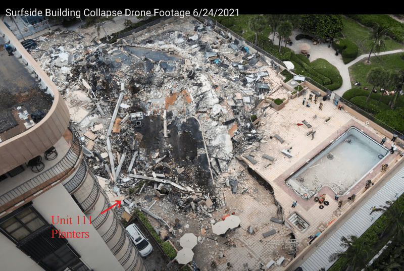

From the drone footage I linked, you can see a large part of the 111 planters still fairly intact.

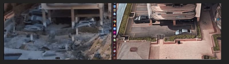

It's interesting how large parts of the deck structure remained elevated despite the collapse. It almost seems as though the west pool deck and upper level parking area collapsed further than the deck directly beneath the collapsed building.
We know that Sara Nir saw the upper level south parking collapse prior to the full collapse. The Stratton account as described by her husband was of the "pool caving in". Clearly she didn't mean the pool itself, but this area west of the pool is more suited to the description. She had a good view of the pool and upper parking, not so much the 111 planters.
For higher resolution views and different perspective, see the video itself.

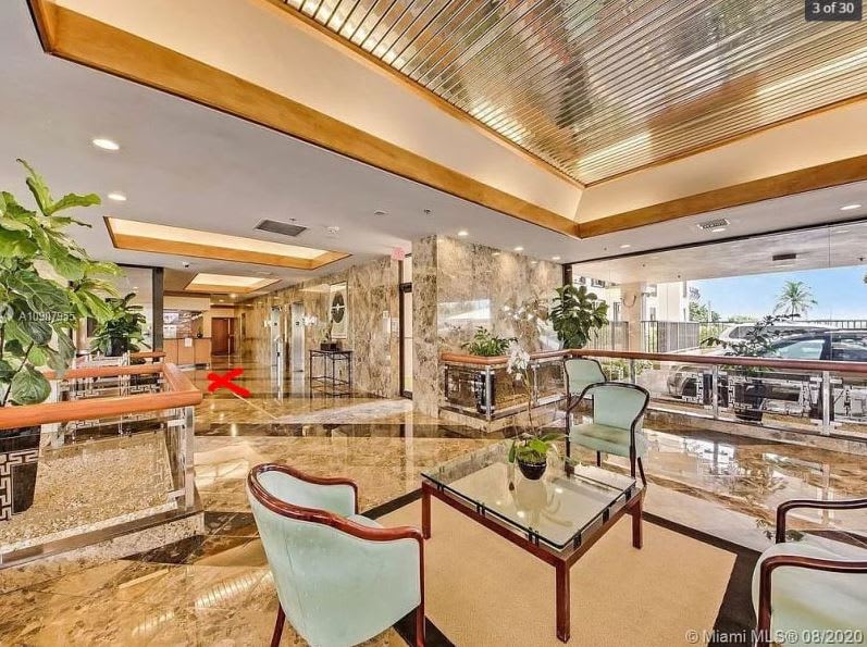

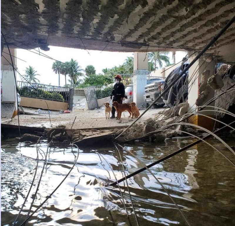

It's become "relatively" clear--based on witness testimony--that the portion of the patio slab, which also served as parking and was visible from the lobby, collapsed prior to the main building collapse. It's still unclear if this area came down prior to other sections of the patio deck, or was brought down by adjacent spans collapsing. But again, it wasn't brought down by the building.
Elsewhere in the thread it has been suggested that the unzipping of the bottom rebar seen here is not unimaginable in high impact collapse events. But here, for this section of slab, we do not have a high impact collapse event--unless you consider a span in the the adjacent bay failing and falling 10 ft. To me this suggests that something is seriously wrong with the ability of the bottom reinforcement to develop (causes have been discussed elsewhere). I would posit that there may exist these rebar development deficiencies building-wide, as similar unzipping instances can be seen in other photos.
Re video from security cameras on the property: the plans show that the security office seems to be next to the mail room, next to the elevators in the part of the building that is still standing. So even if all video recording is on-prem, the servers would most likely be in that room and have survived. There also seems to be slight mention [I could be wrong--forget where I saw it in the plans] of a "telemetry computer" in the office between the trash/electrical room and the front desk (also in an area still standing)? Of course, that was back in the 80's so no idea what that really was or what it would capture. At a previous employer of mine down here, I worked in a building from the same era and our telemetry computer was mostly related to the HVAC system and smoke fans/vents/fire alarm system.
Hopefully someone with jurisdiction has the foresight to check for the CCTV system before they demolish or further disturb the still standing building.
