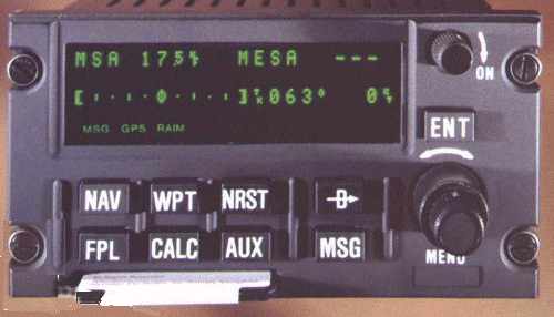

opps chose the wrong picture of the Jetstream cockpit its has a FMS and auto pilot the ones I fly have no autopilot and this is the gps.
Heh, the G1000 makes single pilot IFR so simple. I occasionally go up and do some IFR work in an old C152 just to make sure I can still fly without a computer doing 90% of the work for me. Not going to be one of those pilots who can only follow the magenta line.

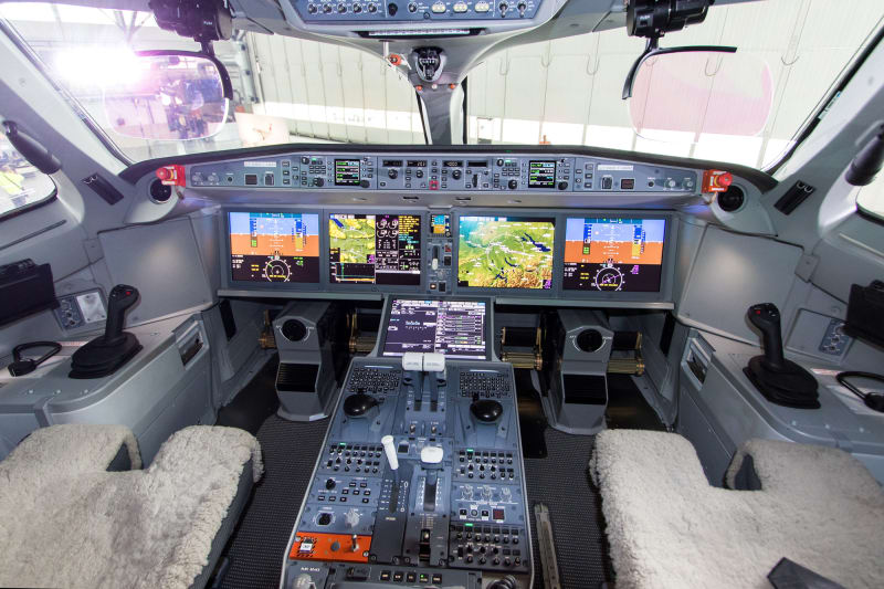

Looks like an A350. What's the giant red button do?
Has Airbus finally made it so you have some feedback on what each side stick is doing? (i.e. Airfrance crash)
Ian Riley, PE, SE
Professional Engineer (ME, NH, VT, CT, MA) Structural Engineer (IL)
American Concrete Industries
It is an airbus but a Canadian one not a French one ;-)
I haven't got a clue what the big red button does. I suspect its a flight test aircraft. They are set up a bit weird because they have huge water tanks in the back and they can pump between them to do the CofG testing and variable weight for the envelope testing.
Always gets the chemtrail lot excited when they see funny buttons and water tanks in the back. closely followed by the flat earth lot asking if the water is flat or at an angle.
I don't remember seeing it on our fleet the couple of times I have jumpseated.
jgKRI said:
That's the eject button, obviously
I think it's an emergency stop.
Brad Waybright
It's all okay as long as it's okay.
Strikes me that the big red buttons are associated with the special red panel in the center console.
Shifting water back/forward, with a valve Open/Close/Fail annunciator on the red panel... perhaps a "dump" on the panic button? Just guessing.
