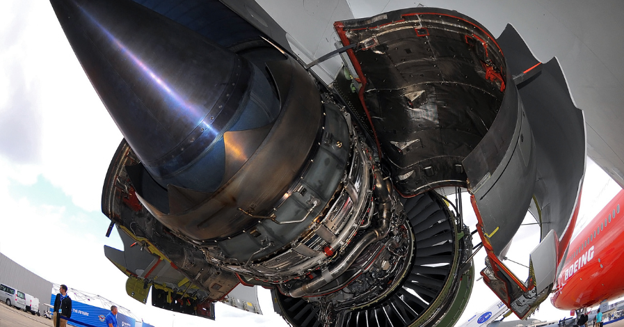

I have never seen a perm mag generator for powering the fadec depicted in any aircraft electrical block diagrams.
On our diesel engines our alternators (permanent magnet generators or whatever) were found to not be very reliable so many of our vessels run battery chargers off the AC electrical system. That was fine in the 1990's when the battery chargers were the mag-amp or transformer based chargers. However, the solid state chargers have become popular and they are not reliable. I say charger but these are really power supplies that use batteries as filters. In my fleet I replace failed solid state chargers in critical applications with mag amp units from a specific vendor.
