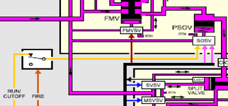

Right away, this part of the diagram shows a spring shut valve held open by a normally closed switch. A loss of electrical power would cause an engine shutdown if this is true. It also shows two pressure sources for a shut off?
This may not be the only way the FMU can cause a shutdown, either. If the metering valves can move to a zero position they can also cause a shutdown.
Also note that the engine has a permanent magnet alternator producing 28V DC to run the FMU. That might rule this out as a source of dual engine shutdown.
