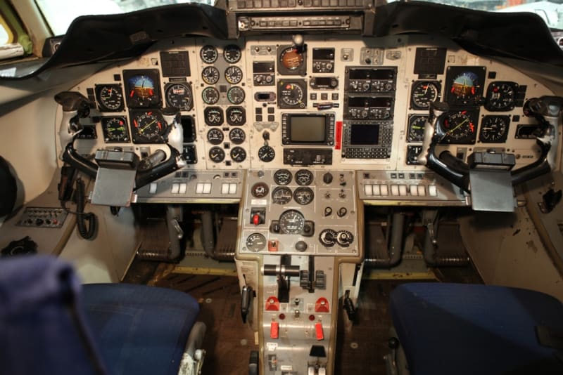

to be honest mate I am legal to fly this. And your G1000 is fancier than the Q400
And this
