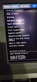

Loss of an engine on a pref A certified aircraft is not worthy of panic especially in a jet.
Unreliable airspeed is a collosal PIA sim session.
Engine shutdown in flight
isn't even a priority procedure.
