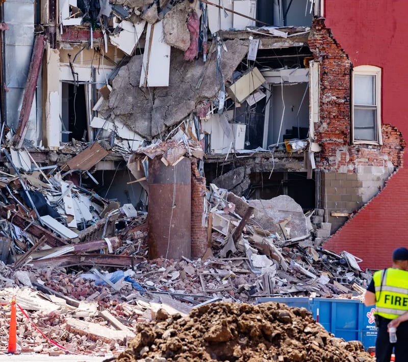

"A six-story apartment complex partially collapsed Sunday evening in the city of Davenport, Iowa, authorities said. It was not immediately clear if there were any fatalities or how many people may be missing or trapped in the building.
Davenport Mayor Mike Matsen said there were "several people unaccounted for," but did not give a specific number or range.
The collapse happened shortly before 5 p.m. local time, Davenport fire chief Mike Carlsten said. The cause of the collapse was not immediately clear."

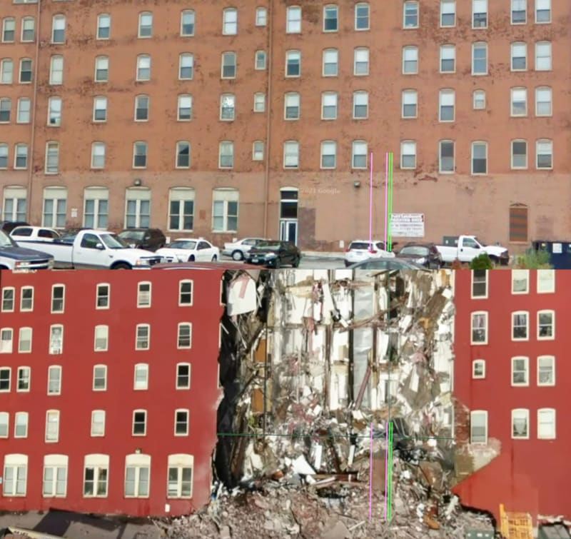

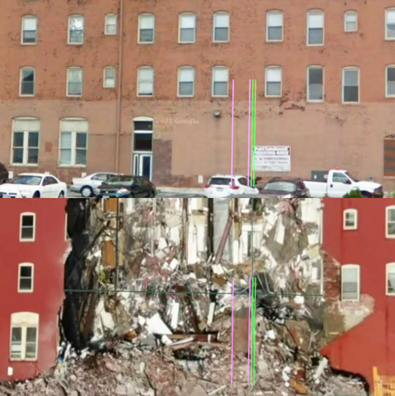

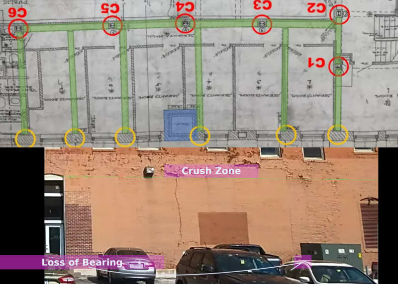

It seems the building was resting on the boiler or masonry wall it sits beside for some time.
I skewed the lower post collapse image to overlay the Google Maps image and the windows map exactly.
Edit: I tuned up the images to reflect the boiler location better.

The reports referred to the potential for facade collapse, not building collapse.
I certainly hope you didn't read into my big post above that I was "going for the kill". I only repeated the lawsuit language and then suggested that there's a lesson here for we structural engineers not to take a 117-year-old bulging, fractured, brick wall lightly when multiple floors depend on it.
The engineer knew there were some serious issues with the wall requiring exterior facade support as well as interior beam support.
In looking at the photos (yes yes hindsight) I would have been very concerned with the situation based on my own years of working with old brick buildings.
So I think you are correct that the engineer's main focus was that this was a local exterior veneer/facade issue and not necessarily a potential for a full wall collapse.
It may also be germane to the situation that this was in Davenport, Iowa, and the engineer was located in Cedar Rapids, Iowa, some 80 miles away so I get the impression that they weren't there at the building everyday.

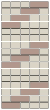

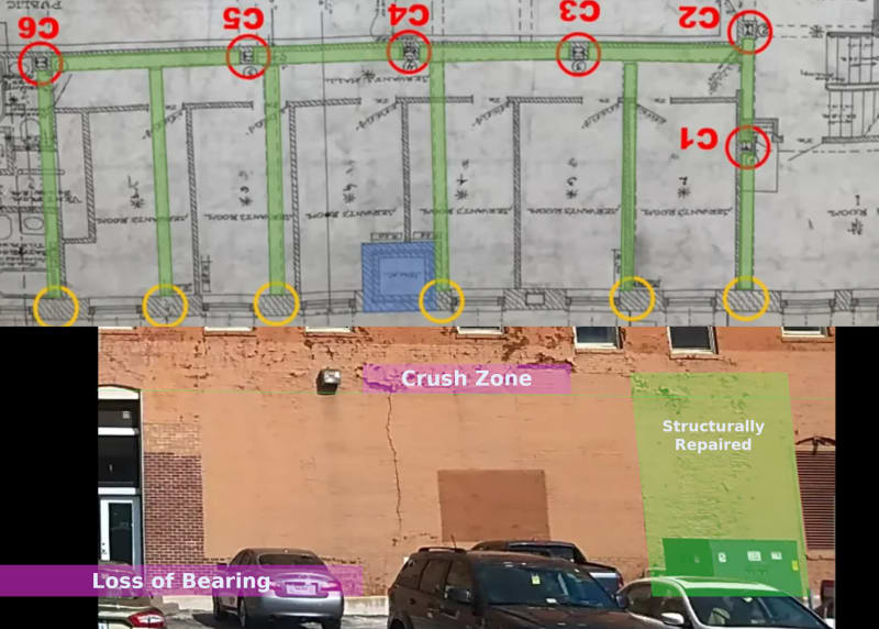

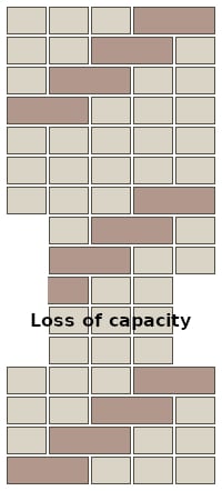

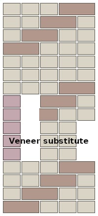

I'll just dump these here. Hopefully they are self explanatory. I have to run.
