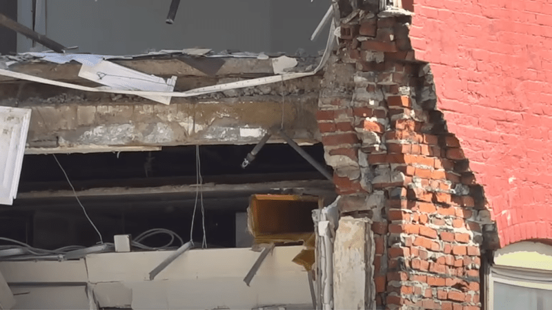

Composite multiwythe bearing wall supporting interior steel frame.

The question is, I think, should he have known? Did he REALLY think that the facade just fell away all by itself? It was so neatly done that it could have only fallen if it were pushed from the hidden wythes, which should have raised questions as to how that happened, and the exposed inner wythes are in such bad shape that one has to seriously wonder why the engineer thought that attaching a relatively new, and relatively pristine facade to crumbling and deteriorated wall could possibly even work.

This would depend on the engineer's knowledge of historic construction methods. In modern construction, this is very possible. I've seen whole walls of brick veneer fall off and not worry the building one bit. Most cavity wall construction more than 40 years old is unlikely to have anything tying the wall together even if it had ties to begin with. In multiwythe, non-cavity walls it depends. If it's a running bond with no tie courses, then you're depending on the collar joints to keep them together and the veneer's contribution to the walls stability is questionable.
There is a sketch for a new column. That is potentially telling. It suggests the engineer did have some concern about the ability of the structure to support itself. But it's certainly not damming on its own. Perhaps a recognition of a coming problem, and the immediate safety concerns of construction would be handled by the contractor. Hard to say, and we're unlikely to have as much information as the experts testifying in the case. It'll be interesting to see what comes of it both technically and legally.
I think the question is do you think the building collapsed on it's own from deterioration, or was the collapse accelerated because of the piss poor shoring. Would the collapse have happened if the engineers drawings had been followed? And if those drawings were followed does the risk of collapse increase enough to warrant an evacuation of the building?
That’s all correct. But the engineer should have known that the exterior walls were load bearing elements supporting the exterior bay line (5 floors of it).
This wasn’t just a facade issue. This brick wall that was bowing, fractured and prompting him to recommend at least a post under an interior beam suggests that he knew the wall was a non-redundant element.
dragon6172, that diagonal shoring wasn’t very serious attempt at supporting the floors of this building.
