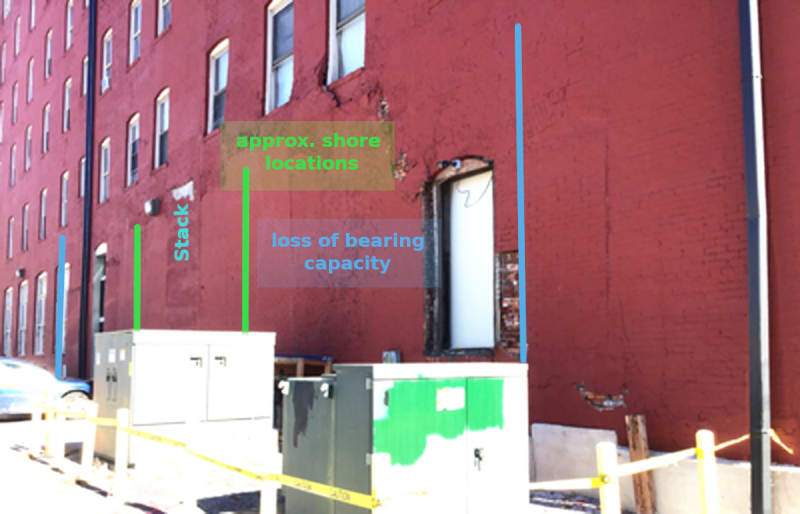

I believe this is a photo of the space accessed by the exterior door with the sidelight and where the May repairs are taking place. The interior finish nearest the door is buckling while the distant surface beyond the jog (and beside the desk) remains sound as the structure is reinforced by the shore post mentioned in my above post.
The image is from a City of Davenport Rental Property Complaint Inspection, July 2021.
City of Davenport

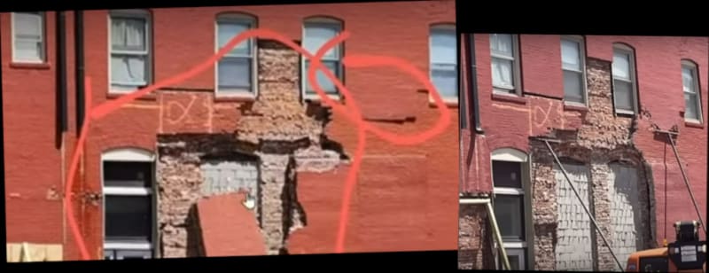

Also, another intervention (a steel beam and shore) is visible in the following image (reposted) from the first Select Structural report, Feb 2, 2023, though there is no indication of when it was installed.
Select Structural
What seems clear is that there is a broad section of wall that has lost bearing capacity through two floors, the middle half which is propped up by additional shoring and the original stack masonry.

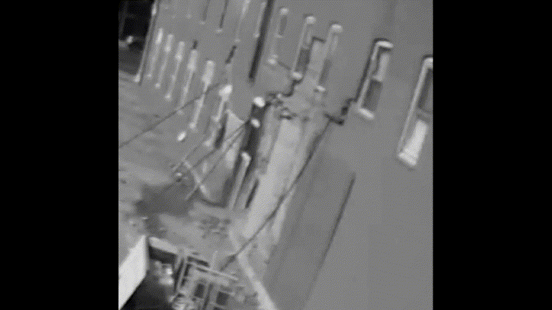

An animated GIF extracted from the CNN video.
In light of my above posts, it seems that the north shoring post is the last impediment to the collapse. The structure weighs down on the shoring post causing masonry above it to disintegrate before the two structural masonry columns south of the door and between the window infills give way leading to the broader collapse. Although a slab of exterior wythe breaks free further south, that is only consequential to the failure at ground level.

Whatever the cause of the veneer slab leaning against the building, whether decay or purposeful removal, further scaling operations on either side of the door look deliberate and I'd say the crew recklessly came close to killing themselves. If all of the scaling operation was deliberate and without any shoring efforts, that would be extraordinarily reckless and given the outcome could or should lead to charges.

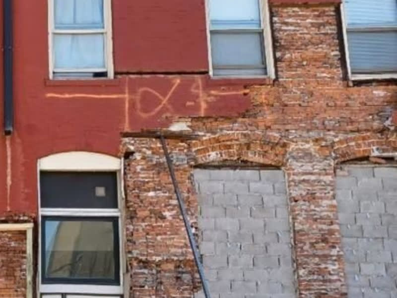

As masonry column A looses its capacity, the masonry/shore combo of column B is overcome and the structure collapses. That's not to say that the masonry column north of the door had any further endurance, but I see column B as yielding first.
As I attempted to describe much earlier, the outer wythe/veneers are indicative of distress but are not a comprehensive description of the full cross sectional distortion. The inner wythes supporting the floor structure can yield to vertical forces while the outer wythe detaches and bulges across a greater surface area. That is to say, the structure was slowly shrinking down from the inside while the outer surface bulged out.
While the outer wythe may become detached and bulge, it still remains propping up the masonry above and pulling it out can be a fools gambit. If I'm missing one label, it's "Mickey Mouse Was Here" under column A.
Edit: Looking back at the animated GIF, the two closest windows crush as the upper floors bear down on them while their sills remain fixed. When column B fails, the second floor bridges to the stack masonry. The south portion of the second floor collapses from the impact of the upper floors.
