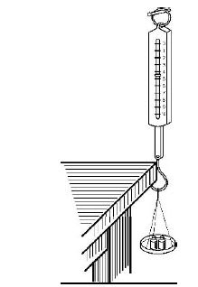

Sometimes it is necessary to look reference books. The following figure is useful to remind the prestressing concept..
Copy and paste from Advanced Stress and Stability Analysis ( V. I. Feodosiev )
Consider a spring balance at the figure and the upper ring placed on a nail and the lower hook after tensioning located to a
rigid heavy table edge as shown in Fig. The balance with this set up indicates 4.5 kg /wt . Now let us hang weights to the lower hook of the strained balance. Until the weight of the load remains less than the specified tension force, balance will permanently indicate 4.5 kilograms. If a weight is placed to pan hanged on the hook is greater than 4.5 ( say 6 kg )kilograms then the indicator will move from its place and will indicate the corresponding weight ( 6 kg )..

that example would give the simplistic bolt loading ... bolt load (indicated on the scale) = P until P=F then scale indicates F.
this is I think an infinitely stiff plate (or a zero stiffness bolt ... or both ??).
