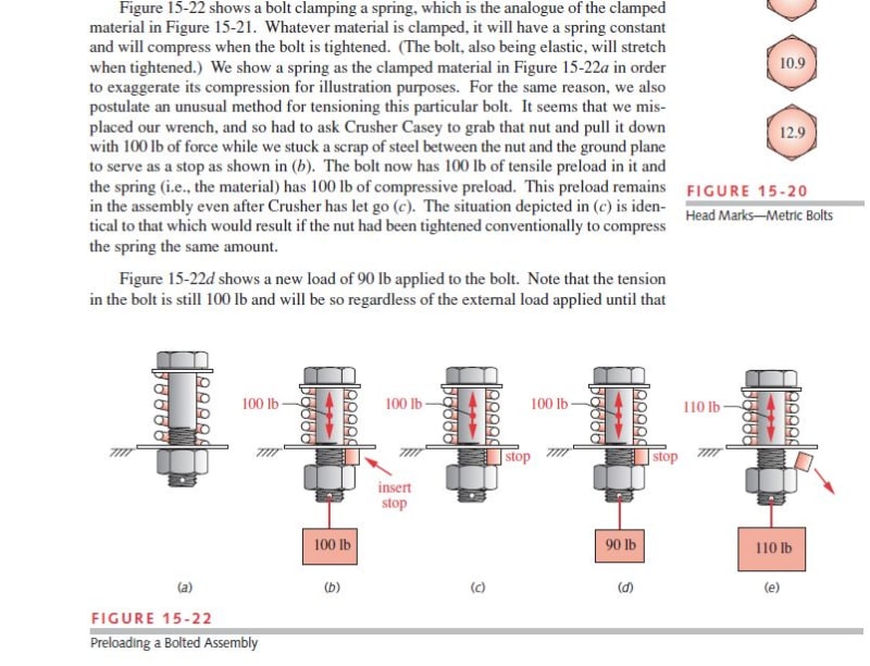

This is another tricky problem to check your knowledge and common engineering sense;)
Given a steel bolt in an infinitely stiff package. First, we tighten the nut until we prestress the bolt with a force P. Then, we pull the bolt with a force F. What is the final axial force inside the bolt (between the head and the nut):
A) P + F
B) F
C) P
D) other (please explain)

HTURKAK said:
Sometimes it is necessary to look reference books. The following figure is useful to remind the prestressing concept..
Copy and paste from Advanced Stress and Stability Analysis ( V. I. Feodosiev )
I'd love to find a video showing the spring scale experiment. I've looked for 20 minutes and haven't found one. Any chance you have one?
I also looked but could not see a video of an experiment. This could be tested if you have spring balance. The following excerpt from NORTON 4th edition shows the concept of preloading .
