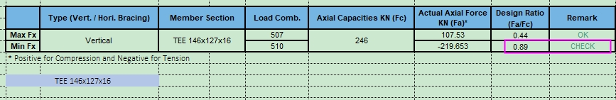

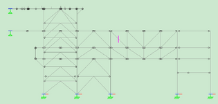

In recent design, ratio for 1 vertical brace connection for TEEUB146 section reached 0.89(<0.85 required, otherwise perform separate check, maximum separate check ratio<1).
This is a truss member.
The capacity given in standard drawing is 246kN and actual tension is 220kN.
In RAM, the separate check proved the actual ratio is 0.85<1.
Is this case safe or not?

You asked about F3125 bolts and their threads. For F3125 type A325 bolts, there are type N bolts which are essentially fully threaded so the shear plane is for the reduced threaded section. Type X bolts do not have threads in shear plane so they have a higher strength.
Additionally, in your screenshots, it appears that the T brace has the same capacity in compression as it does in tension based on the loads and the utilization ratios. That should not be the case, the compressive capacity should be much less than the tension capacity, assuming it is unbraced from end to end.
