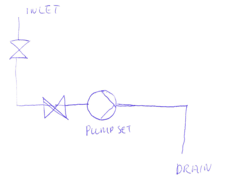

Hello all,
I am adding a system to recirculate the flow of an emergency pumping system.
Fluid: Water
Flow rate: 750L/min
Pressure: 100 Bar
Test time: 4 mins
5 off positive displacement piston pumps, driven by 25kW motors.
In operation the fluid would just go to drain. However, the system needs to be tested each week. To avoid disposing 3 tonnes of water each week, a re-circulation and sampling system is requested.
The recirculation line would feed back into the inlet after approx 10 meters of DN40 pipework. This would not be enough to dissipate heat increase from the pumps the or pressure to go back to the inlet.
By my very basic calculations the delta T is 0.643 deg C, inlet to outlet, so unless there is a way to reject this heat it will almost immediately spike in temperature and the be outside the operating range of the pumps (up to 45 deg C).
I imagine a pressure relief system to dissipate the pressure and a heat exchanger or water tank to buffer some of the temperature change.
This is not my usual field so out of my depth here, any suggestions on the correct way to calculate for this, resources to look at or what solutions you have used or seen in the past would be helpful.

There is no re-circulation line at present, it would just go to drain.
The total circuit for the drain line so far is approx 10 meters which is around 10 litres volume.
Just adding a re-circulation line without tank would be again, 10 meters, around 10 litres volume, total of 20 litres.
The inlet pressure is around 6-7 bar, there is no main tank to come back to, it all comes in from the supply line.

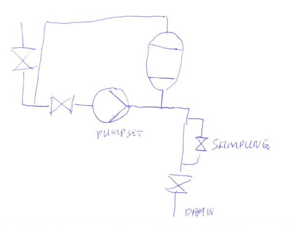

If I add the recirculation line, tank and sampling it would look like this:
If it's all the shaft power I have to account for then I need a tank around 1 tonne in size to limit the temperature rise to less than 10degC.
By c=Q/m*delta_T

what's the strange looking oval shaped thing on the recirc line? = A pressure vessel??
There are two types of test, once a year a full system test with the water coming from the inlet, and would bypass the re-circulation system and go straight to drain. This would be equivalent of test Option 1. There is no back pressure that would usually be present if the system was operating in it's intended function, but that can't be tested directly.
Once a week, there would be a pump test. This would be equivalent to option 2, but the pressure needs to dissipate before being put back into the inlet. Could be an option to prime the system with fluid from the inlet, and then close off the inlet and circulate that load of water.
The actual P&ID is more complicated, I tried to simplify. The weird oval is meant to be a tank, I would add a tank to add fluid mass and heat dissipating area to the system, otherwise there is too little fluid mass. The problem here is if this is filled with water, then there will be no pressure relief.

The problem comes from the small volume of the re-circulation system, the closed loop, option 2, pumping round and round. How to reject the heat and pressure from this system, most of 125kW for 5 mins. That will quite happily boil 100 litres of water in 5 minutes.
Do I add a 1000L tank, long finned radiator pipes, a heat exchanger?
So is it all of the shaft power that needs to be accounted for, 125kW?
OR
only the inefficiency that makes heat? Say 30% of 125k = 37.5kW?
If so, where does this pressure go, can I just dissipate it somehow? Like a outlet spray nozzle into a tank. If this was in steady state, wouldn't the tank just fill up?

Would agree that all power expended at the pumps, in a total recirc loop with no net feed, will appear as heat in this closed loop, assuming heat dissipated to air from pump casing and pipework is next to nothing. So for each pump, you've got 25kW to absorb within closed system + dissipate to air + dump to drain over 4min = 6000kJ.
Check with pump vendor if 45degC is really the upper limit of operation for these pumps, it should be higher. There shouldnt be any NPSH issues, since suction pressure is 6-7barg. The actual upper limit may be related to rod packing, since these are PD pumps.
In reality, you cant have a fully closed inlet. If you do, in a fully closed system with no gas volume, suction pressure will rise to infinity as closed system temp rises, since expansion of heated liquid has nowhere to go. You should have the feed valve slightly open to maintain suction press at 6-7barg, and drain off this small net feed at pump discharge on pressure control. This net forward flow to drain will absorb a lot of the heat generated by the pump also.
If I take credit only for heat dumped to drain, you have a steady state operation; assuming you are permitted to rise 20degC, then you need to dump 18 litres/min per pump. Which is obtained as follows:
Heat generated per minute = 6000/4 = 1500kJ/min
Assume temp rise (from 30degC at fresh feed at suction rising up 50degC) = 20degC
Water Cp = 4.18kJ/kg/degC
Water to be dumped on net forward flow to drain = 1500/20/4.18 = 18kg/min = 18 litres/min.
So for 5 pumps, < 100 litres/ min. So for 4min test time, < 400litres dumped total.
You may not need a backpressure PCV on the drain line to control discharge pressure. If suction pressure is constant, even a plain gate valve on the drain line can be manually throttled to give you 100barg. Then throttle the recycle valve to give you the desired temp rise in the circuit. Or you can do the converse : throttle the recycle valve to give you 100barg, and throttle the drain valve to get you to the desired temp rise.
