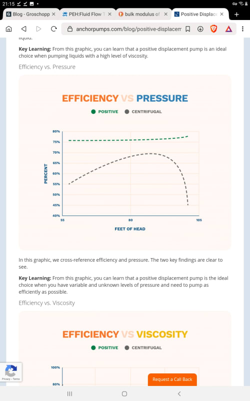

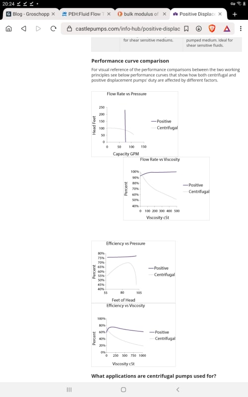

In a gear or piston pump the inefficiency is mostly due to slip. With a low enough efficiency the OP may not even need a recirc as the case drain could be plumbed back to the reservoir or dumped.
Tug, Exactly backwards, but the right conclusion. Yes PD pumps slip. Slip is accounted for by the Volumetric Efficiency Term. Total efficiency, what you see below, is Volumetric Efficiency X Mechanical Efficiency. As you can see, Total Efficiency is still hi across nearly full range of RPM. That's the real advantage of PD pumps. It is because of the HIGH EFFICIENCY of PD pumps at nearly all RPMs that recirculation may not be needed, as the useable work delivered is HIGH, heat generated is LOW. Why and how can you possibly say efficiency is low?
Georgeverghese, Where is your heat coming from? If you think there is forward flow, that was not stated in the example, fine, put them on full recirculation all flow back to suction. Make an example problem of your choice. Pick a reasonable PD pump efficiency curve like those above. Post your calculations. I need to see how you arrive at your conclusions.

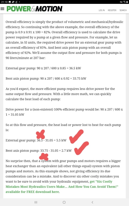

So is everyone happy with the Power Motion page posted 13 Mar 22:20 where the heat is generated by the 5.5 and 2.7 kW components? Is this a characteristic of only PD pumps?
If so, it must follow that we only need to consider full driver (shaft) power for heating when forward flow is stopped. Yes? Now if we opened to a partial recirculation of 30% of total flow through the pump, assuming the efficiency of the PD pump is relatively constant when recirculating and driver power remained at 36.5kW, then does it make sense to calculate temperature rate of increase of the recirculating stream based on 30% of the 36.5kW full driver power applied to heating the recirculation stream and calculating the temperature increase of the forward flow stream using 70% of the 5.5kW as heating the forward flow?

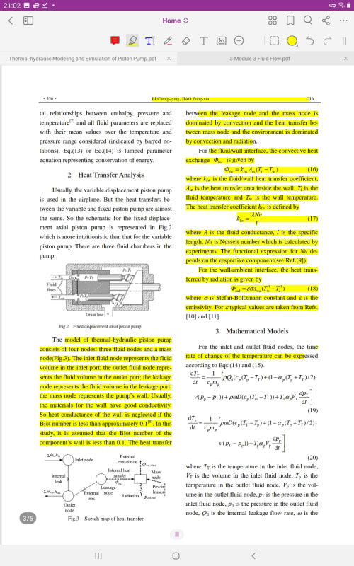

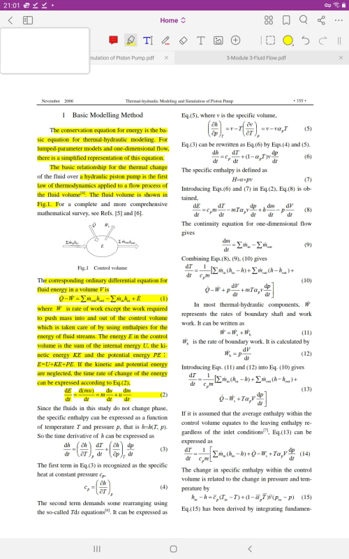

Plus, I stumbled on to this. Can anyone comment on those formulas.
A black swan to a turkey is a white swan to the butcher ... and to Boeing.
Those formulae are all examining temperature rise IN the pump. They do not account for temperature rise in the system where the bulk of it occurs.
I cannot believe that we are still discussing this. In a full recirculation loop, no "work" leaves the loop. All "work" is converted to heat and can only leave though the pipe wall by conduction though the wall. This is the problem the Op has to solve. A fractional flow of water to the drain allows this heat to be removed by the draining water. It really is as simple as that.
