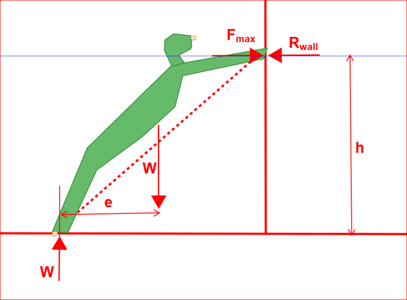

I was pushing laterally on a 20'Hx25'W Great Room wall the other day to show the builder how weak the wall was. With only me pushing on the wall at about 4' to 4.5' from the floor, you could easily see it moving in and out. The wall is almost all windows and doors. It was framed with 2x4 syp wall studs. The upper half is mostly windows and the lower half is windows and doors. It passed city inspection I am told but that may not be true.
There are several framing issues that created the problem, but in shoving on the wall, I told the builder I cannot push horizontally on the wall more than about 1/3 my body weight and that was minor in comparison to the wind the wall was supposed to resist (5,000 lbs or more). The builder claims people can push more than their body weight and used someone bench pressing as an example. I know the bench pressing is not applicable to this.
My question is mainly, how hard can someone push laterally from shoulder level against something when they have nothing bracing them from overturning themselves. I used 3' spread of my feet and 4' to 4.5 for the distance to my shoulder and that is where I get my 1/3 approximation. Does that sound right? (3'/2)xP = 4.25xH ---> H = .375P -----> Ballpark 1/3 your weight.

While the friction would account for sliding, overturning has been my problem. My feet do not slide, but I overturn at some force because my only stability is my body weight and a moment arm equal to half the spacing of my feet.
W*e = Fmax*h
Fmax = W*e/h
W = weight of person
Fmax = maximum force against wall
e = horizontal distance from c.g. of W to c.g. of foot furthest from wall
h = height of horizontal force Fmax

Fmax*h = W*e
image edited
BA

Lomarandil, do you mean they can create a force of 100% while standing still or while moving? In my case, I would be using the standing still value. I can see that squatting down would increase your ability since the moment arm reduces. In the case I am talking about, BAs sketch is very close.
