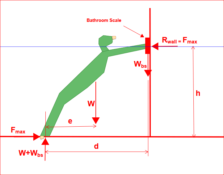

If bathroom scales are used, the weight of the scale has to be included in the equation. This would give a somewhat exaggerated value for Fmax. (See below)
Available friction underfoot would be another consideration.
W*e + Wbs*d = Fmax*h
BA
I think you are using a scalpel where an axe would be more appropriate.
I think it's important to note in BA's diagram the answer to your overturning question. Without e, there's no force against the wall. Try it now, standing vertically see how much purely horizontal force you can apply to the wall while remaining vertical.

Without e, there's minimal force against the wall, I suspect. [pipe]
I rotated my hips and put one foot against the base of the wall and the other foot was about 3' away. Other than that I was abotu what BA depicts.
