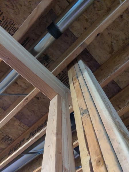

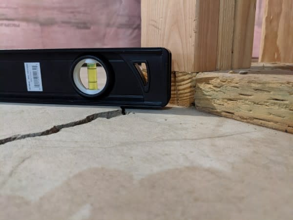

I was asked to look at some slab cracks in an unfinished basement. The house is coming up on a year old (when the warranty expires).
The builder was asked to come and look, and he said they were fine and they would not fix the cracks.
The cracks are near structural posts, and there is moderate elevation change across the crack. The side with the post is lower. I suspect there is not a thickened slab under the post and the post reaction has cracked through the slab. I have not seen any building plans however.
I am wondering if the IBC or some other source I could reference that defines acceptable crack widths and elevation differentials?
Any opinions would greatly be appreciated. Thanks!
looks really ugly... more than shrinkage cracking... just a few questions: is the post and wall sitting on the slab? is the post and wall taking any load? what is the soil like under the slab? what is the construction of the slab?

I'm not sure if there's a footing under the (4) ply post. There SHOULD be, but who knows? The (4) ply is a post that continues through the floor and up to the roof. The (3) ply is header studs.

I'm with dik that's more than just shrinkage cracks. Any expansive soils in your neck of the woods?
What does the connection of the wall look like at the top and base? Typically those should be allowed to float. While likely not the chief cause of the problem it could be exasperating the issue.

How would the post create cracks like this? It seems the top side of the slab would be in compression when considering flexure, would shear cracks present like that, or likely in a perimeter around the post?

Get yourself a hammer drill and determine the slab thickness, potential footing existence and soil quality.
That could certainly be shrinkage if a lot of water was added to the mix. The vertical offset might also be due to slab curling.

In my jurisdiction there are not codified reference for crack widths in a residential concrete slab-on-grade. However, there are Construction Performance Guidelines published by Tarion that are a useful reference. Tarion is the agency that mediates between the contractors and new homeowners with respect to warranty work. Thus they publish a very comprehensive guide that determines what is considered a defect and what is considered acceptable construction tolerances, etc... It is by no means perfect, but it does contain some useful information. Download the guide and look up the concrete basement slab-on-grade section. In my area a typical residential slab-on-grade is 3" thick, unreinforced, and no control joints provided.
These can be difficult and costly to fully investigate. It looks like more than shrinkage cracks to me. Settlement? Settlement combined with part of the slab getting hung up on a strip footing? Heaving? (I looked at one place where we suspected the slab had cracked due to frost heave during winter construction), inadequate subgrade preparation (poor compaction, large stones under slab), poor soil, etc...
You could investigate this to death, or I have had success in the past A) listing as many potential causes of the deterioration (see above), B) proving the deterioration is beyond normal construction tolerances and then C) basically stating that all the potential causes were within the care and control of the contractor, therefore it is the contractors problem to fix.
Looks to me that a hammer-tap or chain drag survey would indicate voids under the slab. Cracks could indicate settlement has occurred due to the column load and poor soil support. Maybe little, if any slab reinforcing.

A simple drilled hole (1/2 inch or 3/4 inch dia) in several places will tell the average thickness, and confirm or deny the location of the needed pads under the vertical column load points. My opinion? No pad, or too small a pad under the 6x column load point, and the concrete slab is being either punched through, or has yielded already and is being driven down into the loose, but now-somewhat-compacted soil under the load point.

No, not 1/4 cracks, all located on the load-side of the vertical column load, radiating from that point load. Too much vertical movement for shrinkage cracking.
Blind Guess: it's cracking that started due to dry shrinkage (most of it happens during year 1), but the post load combined with poor (or no) soil support stressed the slab more than it could take. Reinforcement wasn't enough (or doesn't exist) to resist cracking so here it goes. If you have a Ferroscan in your possession it might be wort to scan locally, I suspect no rebar would come up.
