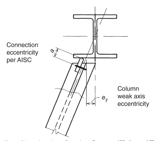

What additional failure modes to be checked for an eccentric skewed shear tab compared to a typical orthogonal shear tab. The shear connection supports high axial load as well as vertical shear and connects to a column flange.
I believe the only differences should be as follows
1) global analysis offsets need to be considered which increase torsion in the supporting column
2) flange bending no longer follows the definition of J10.1 of the AISCM, instead the flange should be checked as a cantilever plate with infinite length per chapter 8 of Roarks. ASD safety factor of 1.67 still to be used for tensile yielding of the flange
3) The weld from shear tab to column will be analyzed slightly different to account for the difference in weld geometry
*Are there any other failure modes to consider in this connection not covered here?
*As a general question how does AISC control certain special cases like this where an approved code equation cannot be used? Is there a general blanket acceptance from the code that allows other analysis procedures per the EOR's discretion?

retired13 I’m not opposed to using a stiffener plate for the column, but I’m looking for a way to quantify the need for one.
CANPRO I would agree that not much changes as far as the shear tab itself is concerned. I have read a couple papers on skewed shear tabs and they all suggest the only difference in design is the weld strength. I will post the references when I’m back at my computer. An end plate would be a good idea, but it will be difficult to do a wholesale change in the detail now if not needed. An end plate would still cause eccentricity as well.

RPMG you are correct there is no torsion being added to the column. I was considering the force components multiplied by their moment arms, but of course they would cancel each other out. Of course should just look at the nice line going through the center of the column :)
Now what say you about the local strength of the flange?

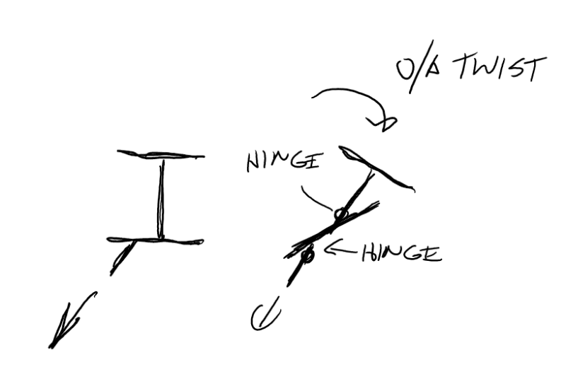

RE: Eccentric Shear Connection
In my mind this is what I was meaning regarding the twist with no stiffening to take the load to where it wants to go:-
Agent66 that was my exact concern with the flange strength, though I was picturing only half of the flange bending, like a cantilevered column supported at the web. I will have to do some thinking on how to prove what load that action will occur. Obviously a portion of the web would have to yield near the flange.

Agent666, I did miss that it was loaded axially. I agree with you assesment of the local flange bending. Stiffeners will likely be required unless the load isn't that high and the columns are really stocky. Be careful using full-depth stiffeners in the column, you really have to be aware of what is framing around and below that location - you can block erection access quickly.
I was also wondering if the flanges of the beam would need to be engaged. I recall you commenting a few times how in New Zealand the building designer also designs the connections. Looks like OP is in the US and likely is doing delegated design work. Connecting the flanges of the beam to the column would need EOR approval unless they were already accounting for that fixity - and if they were, then they should have specified a moment value.
I'd be looking to make a heavy endplate work. But it really depends on the beam and column section, geometry, and loads. Any chance we can get a sketch and loads?

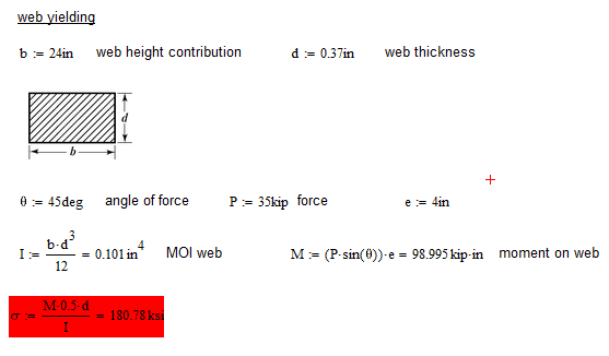

Agent666
For the effect that you mentioned to occur, with the flange hinging about a point on the web, the cross-section can be checked for a calculated torsion force to see if it yields to form the plastic hinge? The problem would be determining the length of the beam web that participates in the strength. I very un-conservatively assumed 2 ft contributes and did a quick calculation and I think you are very right.
edit: retired13 there are pre-qualified welds for skewed tabs in the back of chapter 10 of the AISC manual. This tab should have a two-sided fillet weld, larger on the obtuse side. I don't have my code handy or I would give you a snippet.

A paper from AISC, which is very helpful for your situation. Link
Thank you for your contribution retired13, very good information. I'm not sure why there would be a discrepancy between AWS and AISC on allowing fillet welds for the joint, but I feel comfortable using AISC's method and I see no reason why it wouldn't work. Your link hit the nail on the head on page 5 showing the AISC approved weld.
OK. Another AISC paper that contains the exact details as shown on yours (see Fig. 9). Link

You’re absolutely right, Dik. There is improvement in that switch. Not a complete resolution however.
