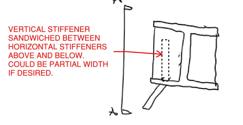

What additional failure modes to be checked for an eccentric skewed shear tab compared to a typical orthogonal shear tab. The shear connection supports high axial load as well as vertical shear and connects to a column flange.
I believe the only differences should be as follows
1) global analysis offsets need to be considered which increase torsion in the supporting column
2) flange bending no longer follows the definition of J10.1 of the AISCM, instead the flange should be checked as a cantilever plate with infinite length per chapter 8 of Roarks. ASD safety factor of 1.67 still to be used for tensile yielding of the flange
3) The weld from shear tab to column will be analyzed slightly different to account for the difference in weld geometry
*Are there any other failure modes to consider in this connection not covered here?
*As a general question how does AISC control certain special cases like this where an approved code equation cannot be used? Is there a general blanket acceptance from the code that allows other analysis procedures per the EOR's discretion?

I would think the more complete resolution was what was proposed earlier using a stiffener to provide a sensible load path for axial load. Oh and recognise that there is some decent shear lag there, but likely fine.
I would imagine something like shown below subject to specific design would deal with the load path to engage the entire cross section.
The 35kip (135kN) force seems fairly small (to me at least), I was imagining large axial force = 1000kN or something.
The cleat with the bolt holes might also require some stiffening due to it being an eccentric connection as opposed to concentric connection for the axial loading component. Can't imagine with that small force it would be an issue though, but should form part of any robust procedure checking for eccentric axial compression connections.

I feel that this entire discussion lacks something quite critical: an understanding of where this beam's axial load goes after it hits the column. Can you expand upon that? The overwhelming majority of the time, that axial load will either be:
1) Passed horizontally through the column to a another beam or:
2) Passed vertically through the column to a vertical bracing element.
Where the load ends up when it exits the column, and how it gets there, may significantly impact the choices that a thoughtful engineer would make with respect to the connection typology. It is possible that the engineer of record intended to for the beam axial force to truly die at the column as column shear, flexure, and torsion but I would consider that to be an extremely rare, and often unwise, decision on the part of the EOR.
MegaStructures said:
Adding stiffeners through a large project would be costly, so I feel like it should be proven that the stiffeners are needed.
I don't feel that it is the case that you should only add stiffeners if it can be proven that they are needed. Rather, I feel that you should only omit stiffeners if you can prove that they are not needed. Obviously, this thread only exists because you are struggling with the latter. Here, your imperative to please your client diverges from your imperative to safeguard the public. I get it, we've all been there. Frankly, we never really leave there.

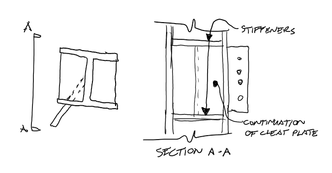

In connection design, one must accept that much is, and always will be, unknown. Consequently, a measure of humility and conservatism is warranted. As an example, connection flexibility has not yet been mentioned in this discussion. A general principle of good steel connection design is to avoid force transfer via plate bending as much as possible. That, because plate bending implies behavior that is flexible and, therefore, less predictable. Yeah, we violate this principle on a pretty regular basis but, in my opinion, it's wise to stick to it in unconventional situations. See the sketch below for some flexibility related concerns that I have as well as some additional checks you might consider.
Love it. This is just the kind of direct and stiff load path of which I feel Blodgett would approve. That said, I do feel that we could improve upon it from a fabrication perspective without sacrificing intent.
