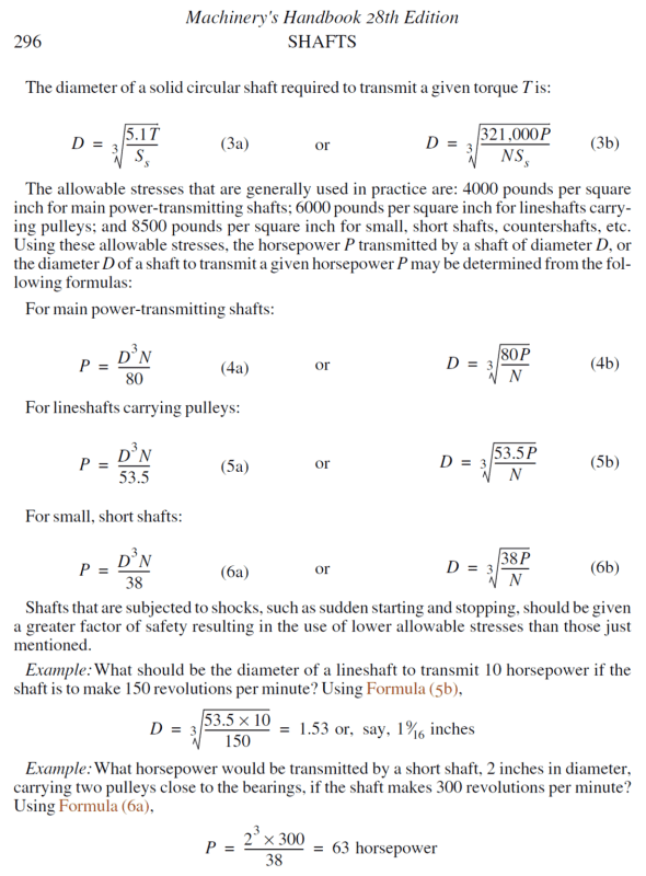

I went into my math model (which defines values for my parametric CAD model among other things) to review how I selected my bearings and found I based the selection on shaft size; I applied a 5x safety factor to the 4000 psi stress limit (800 psi max stress) used to transform equation 3b to equation 4b below. In the cell where I specified the 5x safety factor, I have a note that says "required to force selection of the same bearing as the Honda GX200 engine which produces slightly greater HP and torque." [neutral] Since my six cylinder radial two-stroke engine is far more balanced than the single cylinder GX200, I feel the selected bearing is more than adequate. It's just not a very pretty method. I hang my head in shame. [mad]

Just looked at his Hartog link. I can understand that the gas pressures equal out as far as vibration,That's one thing... but the stress path from the top of the cylinder to the shaft is still through the main bearings. Are you saying the bearings would not "feel" the gas pressure load(s)?
I'm thinking of it like this... If I motored the engine up to it's RPM with an external motor... that would be how I would balance the rotating mass (pistons, wrist pin, con rods, crank) I got that under control. But with actual combustion that force is getting sent into the structure of the cylinder, bolted to the crank case, radially through the main bearings, into the crank shaft.
Trust me... If I'm wrong I would be ecstatic because that's a MUCH smaller (cheaper) bearing. Will look for your Mack and Shaw when I get home.
