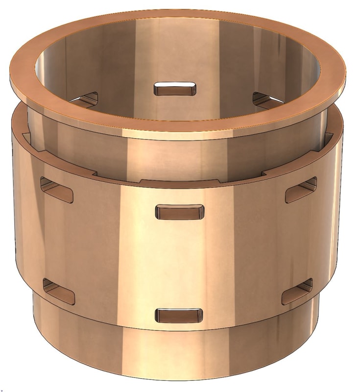

hydrae,
The heat capacity of oil is about half that of water (approximately 2 and 4 kJ/kg/K respectively), so I have to move twice as much oil around the liners as water to move a given amount of heat from each cylinder. Toward that end, I have eight coolant channels radially distributed around the active portion of the liner (and complete coolant surround of the liner regions where the pistons "park" with their associated ports fully open).
The engine is a rotating cylinder radial in which the spinning rotor serves as a centrifugal oil pump. I use roller bearings throughout, which means I have no need for pressure, and the entire oil loop thus operates with high flow volume as required for cooling.
I don't view this approach as terribly high risk, but will verify its operation during the critical experiment phase.
