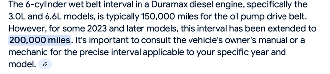

For sure. Ford EcoBoost small engines and the 6 cylinder Duramax. The Duramax requires the engine to be removed to replace it as it is at the back. Really a dumb idea. While on the subject - look at Audi engines. About 6 timing chains located at the back of the engine. Who comes up with this crap?
