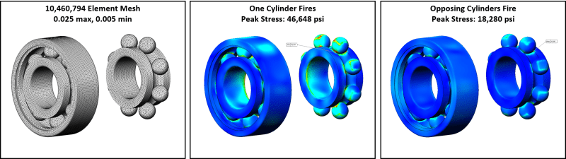

Not being happy with my kludged selection of bearings based on shaft diameter alone, I decided to using my modeling tools to see what stress my bearings are under.

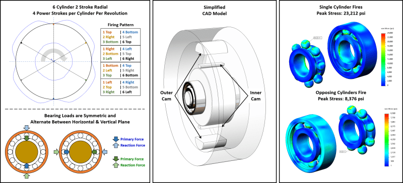

My engine is a six-cylinder, opposed-piston, cam-driven, two-stroke in which each cylinder produces four power strokes per revolution. This arrangement, shown in the left figure below, results in two cylinders on opposite sides of the engine firing simultaneously. The firing pair alternatives between a vertical pair and a horizontal pair. The middle figure shows the simplified CAD model I created for quick analysis of bearing stress. The model describes only two opposing cylinders in vertical orientation within the rotor assembly. The opposing pistons in each cylinder have been reduced to just their cam radius with a flat face to which 2,915 lbf (the product of my peak gas pressure and piston surface area) is applied. The bearing model (6202 selected without the 5x safety factor I mentioned in my last comment) was downloaded from the supplier and the material specified as ASTM 52100 bearing steel having 67 kpsi yield strength. All other materials are Maraging 350 steel with 295 kpsi yield strength (associated with 600F).
The right figure captures the result of static stress analysis in which all components but the bearings are hidden from view. I have also hidden the outer hosing of the most healily loaded bearing so it's balls are visible. The top plot shows bearing stress when only one cylinder fires. In this condition, the peak stress on the bearing is 23,212 psi, 1/3 of the bearing material's yield strength, too low for long term fatigue life of the bearing IMHO. The lower plot shows bearing stress when the two opposing pistons fire simultaneously. In this condition peak stress falls to 8,376, about 1/8 of the bearing material's yield strength, likely adequate for long term fatigue life IMHO.
This quick study illustrates an important phenomenon. Note the hot spots above the bearing balls in the top stress plot and compare them to the widely distributed load on the outer shell of the lower plot. Even with twice the loading being applied to the central shaft and the rotor of my engine, the peak stress has fallen by a factor of 2.77. Factoring in the doubled load, that's a 5.54 x reduction in peak stress.

I understand bearings are dynamic devices. I used static analysis at the worse case condition to get a feel for the loads resulting from my opposed-cylinder arrangement with no mechanical imbalance (in theory). From the analysis, it's clear the arrangement has great impact on the stress on the bearing. The mesh I used isn't terribly coarse. The minimum element size (0.01in) was selected by Solidworks based on the minimum radius in the design. I only use 2D symmetric analysis when I need to. This particular analysis only takes about an hour to run on my analysis machine (12 cores/24 threats at 3 GHz), and I'm free to work on my other less powerful workstation while the analysis runs.

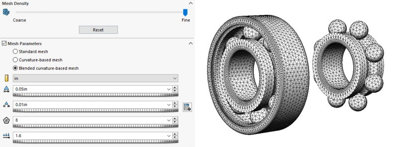

In calculating your average force, don't forget much of the force on your pistons is translated into rotational force by the crank (or cam in my case). In my FEA runs (updated below with finer mesh and proper material properties), I assume the entire combustion event occurs at top dead center (detonation), the worst case (I obviously plan to control timing such that this doesn't occur, but it will likely happen now and then during testing). Note both plots below use the same color scale, and they clearly illustrate how little load is on the bearing races when opposed cylinders fire. Max deflection of any bearing component is 0.00047 in.
