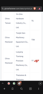

Hi
I want to know what is meaning of TS that show before B7 on stud bolt
Do you know any specifications or standard explain it
Thanks a lot
It's the manufacturer's ID mark.
The controlling standard is ASTM A193.
bolt manufacturer identification markings
Put this into your search engine and you can identify the manufacture.

Can you explain about your idea how can I identify manufacturer with TS
AI is incorrect in this case.
TS is likely Yin Shin Hardware Industry Co., Ltd, of Taiwan.
I search "ts b7 stud bolt" but search engine show several suand can't find special manufacturer
I think it's not correct because not work
Are you in China? Search engines may be restricted in that case. As for the "Tensile Strength" you saw in AI, this is a great illustration of why you should not believe everything it comes up with. Know that quality dictates every fastener manufacturer put their mark on the head.
