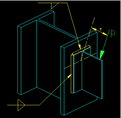

Hello!
P1 and P2 have exactly the same conditions except top, bottom horizontal welding.
I thought P2 could support greater vertical load.
But...
Which one do you think can support greater load? Why?
Thanks!
JW
R

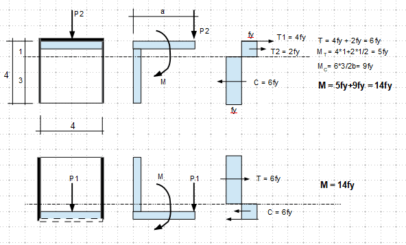

First time done limit state based weld calculation. Please advise for mistakes, if any.
No mistake, r13 other than the assumption of no direct bearing at the bottom. T1 alone provides a moment M = 4Fy*4 = 16Fy when direct bearing is considered. The question the OP asked was:

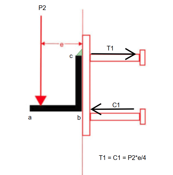

BA,
At the case for P1, wasn't there a force of C1 = 4fy (see sketch). With or without weld, the compression was counted. I am confused on your used of full member depth as the lever arm.
r13,
That is really what the disagreement has been about. It is not a theoretical disagreement as we all agree (I think) about the capacity of the weld when direct bearing is not considered. When direct bearing is considered, reactions T1 and C1 are separated by 4 units.
If the back surface of the angle or the exposed surface of the embed plate is not planar, the argument is that there could be bearing somewhere between b and c (see below). If that were the case, however, inspection should reveal a gap at point b, in which case steel packing could be added between the two surfaces. It is also true that, as P2 is increased, any gap at point b will tend to close.
BA
Got you. It is more complicate than I thought.

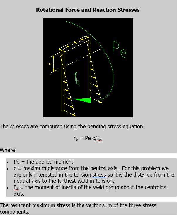

Hi r13
I have copied an extract from the Steel Construction Manual see attachment it clearly states the calculation doesn't take account of any compression connection between mating parts, which as BAretired said is were we differ.
Also I have pasted the link to the site for reference.
desertfox,
We are in line with each other. The compression BA mentioned is something else, that is usually not considered in the weld design. Thanks for the reference, which is quite illuminating.

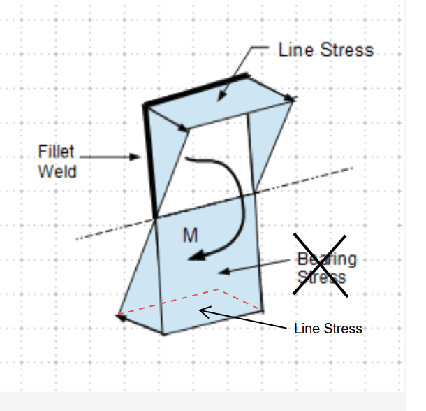

I guess this is the case some people has in mind.
there shouldn't be any line stress in the lower half the weld is only on three sides
But cheer up, desertfox. If the point load is rotated 180o, then P1 is the stronger configuration.
BA
The diagram I posted is illustrating the stress in the weld only, which is actually what I thought we were interested in for the elastic method.

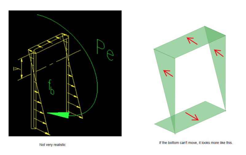

BA,
Can you show the axis of rotation?
desertfox,
The diagram I posted is the stress in the weld, assuming the heel point is fixed against horizontal movement.
r13,
The axis of rotation is the heel of the angle.
