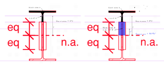

Let's say I need to use a web plate instead of a flange cover plate (I know...) to reinforce a beam. How do I calculate the required weld to ensure the section acts compositely? The shear flow equation gives the shear along a horizontal plane, but in this case, the faying surface is vertical. I can't quite wrap my head around it.

@BAretired is correct the definition of Q in VQ/I formula is the first moment of area above or below the shear plane being considered
This is how I've always understood it as well. You're only using the area past where you are trying to find the q value for.
Giving it more thought VQ/I at the top and bottom of the reinforcement plates is 0, still would be curious to see the model with intermittent fasteners at the top and bottom of the plates rather than at the centroid.
Exactly. I have modelled it and it doesn't matter where the fasteners are located they are only transferring vertical shear. This is exactly as one would expect because there is no compound action. And no longitudinal shear demand on the fasteners. (To be pedantic if the fasteners are intermittent then you do have some extremely small longitudinal shear demand.)
Of course there is longitudinal shear flow in the plate and in the web of the beam but they are equal so there is no shear demand on longitudinal fasteners. (No shear flow between the plate and the web as I expressed earlier.)
VQ/I is zero at the top of the cross section, but not at the top and bottom of the plates.
I agree with this 100% this approach to the calculation IF we were trying to calculate the shear requirements of fixing that top T to the rest of the assembly. And my next step check whether that web is strong enough to transfer the shear which it is. Hence no welds required to transfer

What matters here is that if in the absence of a connection there would be a discontinuity in the stress gradients. This discontinuity needs to be resolved if there was going to composite behaviour.
But in the case of members that have a common centroid there is no discontinuity in the stress gradients if they are simple 'sistered' together. stress and strain are identical. Thus there is no discontinuity.
YET ANOTHER EXAMPLE:
Consider a Square hollow section cut down its axis and calculate the shear and the weld required. Using VQ/I in the major axis we wouldn't required any weld as the resistance to bending is unchanged. The calculation unsurprisingly yields a ZERO result. Though calculate it for the minor axis and you have a completely difference result, again as expected. You'll find yourself needing to weld that cut back up to restore the strength stiffness in the minor direction.

If the beam is being loaded by UDL applied to the top flange, doesn't the weld from top and bottom of the reinforcing plates need to be sized for Q, similar to how you'd do it if you were reinforcing with a T as BA drew? Otherwise how does the side plate go along for the ride if it's not designed for the stress to act compositely?
If the load were applied such that the plate and beam both got engaged, say with screws into the side (just as an example) then I'd get that they both get loaded, but otherwise how does any load make it into the plate without sizing for Q?
Good question.
The side plate goes along for the ride by providing sufficient fixings to transfer the vertical load. This could be screw, bolts, welds, or whatever regularly spaced. Those fixing would need to be designed for the proportion of the UDL load transferred which could be calculated by the ratio of plate stiffness to I beam stiffness. It would be very low and much lower than an incorrectly applied QV/I shear calculation. The load also acts in a direction perpendicular to the shear value that is calculated by QV/I.

People keep talking about this member acting compositely. When it really isn't. It is acting in tandem, as though it three sistered sections, not compositely. If you doubt this just calculate the I value for the 'composite' member and the I value for the sistered member. They are identical. You are not getting composite action.
When designing for connections for a composite beam you need to allow for shear in two direction. Longitudinal and in the direction of the load (down for a normally loaded beam). QV/I is only half the story. In this case it equals zero, but the other half doesn't which I've pointed out repeatedly.
Horizontal shear in the web and side plates must be resisted by welds top and bottom of side plates. The value of Q is shown below in two places, at the top of plates and at the neutral axis. Horizontal shear stress is VQ/It where t is the material thickness at the position under consideration. At the neutral axis, it would be the web plus side plates. That is true and cannot be dismissed by using faulty arguments.
In this case, little is gained because the side plates are only about half the depth of the beam. Much more effective would be to beef up one or both of the beam flanges, but this is the problem we were asked to address.
The horizontal shear at the top of the side plates is zero. The only area where shear can be anything but zero is at the corner of the side plate and existing web - but in any case this is the same amount of shear in the web as was there before the plating.
Just above the welds, the horizontal shear is in the beam web, not the side plates. Just below the welds, shear is shared by the side plates, although there could be a bit of shear lag, so the shear stress needs to build up. I agree that Q above the welds is unchanged by the presence of side plates, but it starts to increase to a maximum at the neutral axis. But depending on the thickness of side plates, shear stress may actually decrease at the neutral axis.
