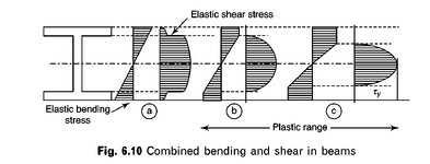

Another complication with shear flow occurs when we design beams stressed beyond the elastic range. The factored moment M = phi*Z*Fy (Z is the plastic modulus). That may render the formula VQ/I inaccurate for part of the beam because 'I' is an elastic property.
I disagree. 'I' is not an "elastic property" it is a geometric property. And unless the geometry of the section changes then 'I' won't change (Any plastic deformation isn't going to change the geometry significantly). Thus VQ/I doesn't become inaccurate in the plastic range.
Again, you are bloody wrong! It is a geometric property which is used in the elastic range, not the plastic range.
It is a geometric property (have a look at any basic definition) that exists inside the elastic range and in the plastic range. It isn't a property that disappears if there is plastic deformation. If you are referring to the EI formula to determine stiffness it is the E that effectively changes. The 'I' remains the same as long as the section retains its geometric shape.
My/I is not correct for stress in the plastic range.

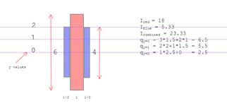

Here are a few 'q' values for your amusement. Note that q at y=2 is unchanged by the presence of side plates.

The explanation is that moment of inertia is the wrong property to use in the plastic or partial plastic range.

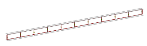

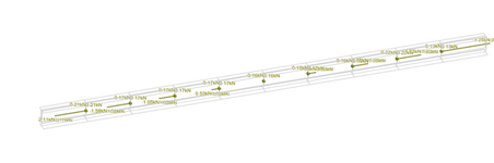

For those who like to see visuals and let computers do the work. Here is my representation of a beam with plates under UDL. I have an I-beam and two symmetrical plates with a rigid fastener staggered along the beam.
BELOW WE HAVE THE SHEAR FOR DIAGRAM SHOWING NO LONGITUDINAL SHEAR TRANSFER BETWEEN THE BEAM AND THE PLATES.

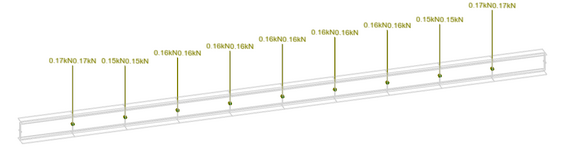

AND BELOW IS WHAT HAPPENS WHEN I OFFSET THE PLATES IN THE VERTICAL DERIECTION WE GET LONGITUDINAL SHEAR TRANSFER AS EXPECTED. INCREASING TOWARDS THE ENDS AS EXPECTED.

It relates because it shows the shear flow between the plates and the beam which is exactly the original question. It shows no longitudinal shear flow. In the second image I offset the plates to check that the model behaves as theory would expect, which it does.
Of course in all this discussion there longitudinal shear flow within the beam and the plates. But we don't care about that we only care about the shear flow BETWEEN the plates and the beam.
Shear flow BETWEEN plates and beam is not defined. The plates are welded to the web of the beam. We need to think of the red and blue plates on my sketch as a composite unit. We care about the strength of weld required to generate the shear flow in the blue plates (which is not zero).
I din't respond to this point earlier as I didn't know what or how your were calculating things. And I still don't. But it seems you have a non zero value for when y=0 which presumably is the at the centroid. But this flies in the face of the one of the definition of the centroid as the location where the first moment of are are equal to zero.
