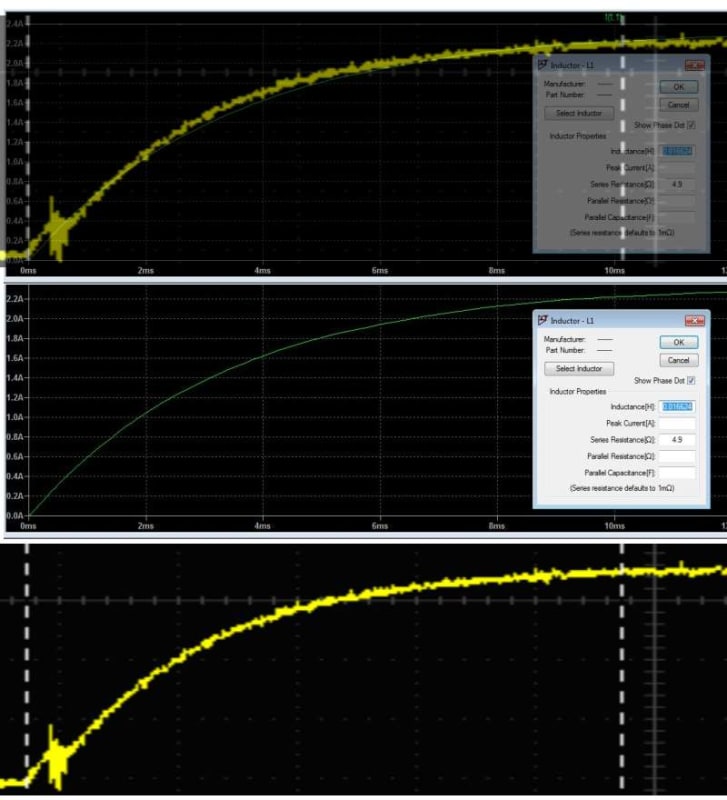

@skogsgurra When I did the coil test, I was simply switching the coil on and off with an IGBT, so I guess my scope trace will be different to that if I had been feeding the coil a sine wave voltage like your one with the AC supply. I still haven't got a chance yet to repeat that test.
So here is the screengrab from the actual coil test. The horizontal markers on the oscilloscope screengrab are set at 10ms apart, then aligned with the LTSPICE 10ms markers. I did stretch the image in the vertical direction, as the actual recorded current was only 1.8A
