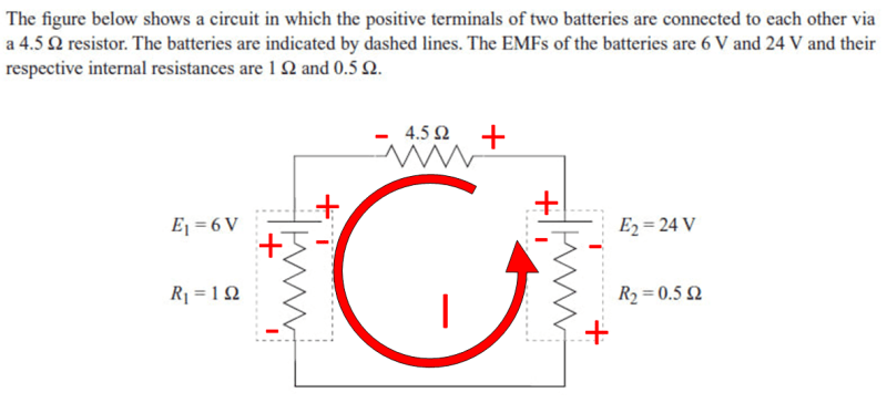

The question says "What is the resultant EMF in the circuit?"
Hello,
I am not an electrical engineering student/engineer, but I have a related question I was hoping someone could help answer.
Here is a picture of the question:

The formula is not used because the answer is given - the EMFs of the two cells are plainly stated and EMF is constant. With the cells in opposition the EMFs for the circuit subtract.
EMF is what adds energy to the system and that energy is added at 18V.

1. Remove the 4.5 ohm load , the LHS battery EMF is 6 V and the RHS battery EMF is 24 V.
Note: (a)This is the EMF voltage across the battery when NOT connected to any load = open circuit voltage.
(b) the battery internal resistances of 1 Ohm and 0.5 Ohm respectively, are irrelevant.
2. When the 4.5 Ohm load is connected:
2.1 the loop resistance R=4.5 + 1 + 0.5 = 6 Ohm.
Note: Both batteries internal resistance of 1 Ohm and 0.5 Ohm are considered connected in series with the load 4.5 Ohm.
2.2 The current I = E/R ...A . i.e. 18/6 = 3 A
Note: (a) E = 24-6 = 18 V
(b) battery internal resistances are irrelevant.
2.3 the RHS battery is discharging 3 A
Note: (a) voltage drop across the battery internal resistance vd = 0.5 Ohm x 3 A = 1.5 V .
(b) the voltage across the battery would be EMF - vd = 24 V - 1.5 V = 22.5 V.
3. Summery: The voltage across RHS battery = 22.5 V .
And the LHS battery is charging 3 A.
But, The respective terminal voltages are now LHS 9 Volts, RHS 22.5 Volts.
The voltage across the 4.5 Ohm load is 13.5 Volts.
The internal voltage drop on charging is the opposite sine to the voltage drop on discharge.
Better to stick to EMF and KISS.
Final proof:
13.5 Volts/4.5 Ohms = 3 Amps.
Ohm's law

1. The loop current is 3 A.
2. The RHS battery is discharging 3 A (i.e. current flow out of the RHS battery terminal + to LHS battery).
3. The voltage across the load resistor is V=I x R = 3A x 4.5 Ohm = 13.5 V (i.e. current flow from RHS towards LHS).
4. The voltage across the load resistor would be 13.5 V (i.e. RHS + and LHS - )

This is the OP's circuit annotated. We arbitrarily assert that the conventional current is flowing CCW, although we pretty much know that has to be, since the larger battery will dictate the current flow.
Since conventional current rules make the incoming end of a component positive, the signs will correspond to the voltages measured across each resistor, assuming the current direction is correct. This corresponds to the equation I originally posted. When the equation is solved, the current is positive 3A, which means that the CCW direction was correct. If we had asserted the current was CW, then the solution to the that loop equation would have been -3 amps, thus correcting the flow direction to CCW.
If the two battery voltages are swapped, then the conventional current would correctly flow in the CW direction.

"EMF is the voltage across a battery when it is NOT connected to a load"
EMF is a constant and is given in the diagram.
What isn't constant is the voltage across the internal resistance. It doesn't matter what is hooked up, at least until the chemistry inside the cell is consumed.
If they want the EMF it is what is stated on the diagram
If they want the battery terminal voltage for that circuit, that's also been calculated here but is not EMF.

EMF is given in the problem statement with identical values for E1 and E2. Since they are identical they cannot be in-circuit voltages.
They are trying to see if you know what EMF is and are adding information to get you to calculate voltage drops and in-circuit voltages and waste your time.
Stuff like this goes right to getting the spoon out....
This problem is really old, and the apparent answer is supposed to the EMF of the simplified circuit, which is the difference of the battery voltages, which makes sense that the answer might be 18V

The answer is 18 Volts EMF.
+24 Volts EMF - 6 Volts EMF = 18 Volts EMF.
Keep working on it until you are able to successfully subtract 6 V from 24 V and get 18 V.

The figure below shows circuit in which the positive terminals of two batteries are connected t0 each other via a 4.5 Ohm resistor: The batteries are indicated by dashed lines. The EMFs of the batteries are 6 V and 24 V and their respective internal resistances are 1 Ohm and 0.5 Ohm.
10) What is the resultant EMF in the circuit? 6V 18 V 24 V 30 V
11) What is the current flowing in the circuit? 5A 4A 3A 1A
