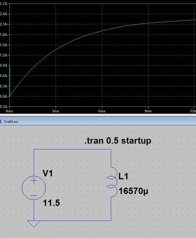

Well, I have done some editing to the LTSPICE file, and have whittled it away bit by bit, until I am left with nothing but a single inducter and a 12V DC supply.
But strangley, even then, when I run the simulation, it saturates instantly.
Obviously that isn't possible in reality.
I tried huge Henry values and it is exactly the same as with minute values.
Can someone please suggest what I might be doing wrong?

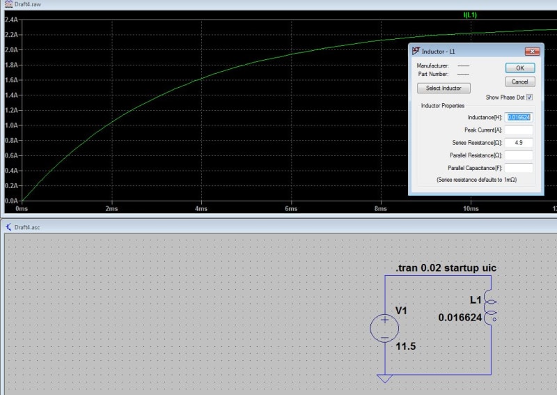

I have in my hand an actual inductor which is 16mH. When I connect this to a 12V battery it saturates in 10ms at about 1.9A
Surely something as simple as this should be easy to simulate, but even then when I model it, it also saturates instantly, so I am obviously not using LTSPICE properly.
Any suggestions?
Can anyone model that please, since it is only two components and takes ten seconds.
I got it sorted.
The initial voltage needs to be set at 0V for the start of the simulation run.
The simulation does match reality pretty well now.
Steady state is not the same as saturation.
Your numbers are not working for me.
I calculate that it will take about 0.5 seconds to reach steady state.
Where did I go wrong?
12 Volts / 1.9 Amps = 6.32 Ohms.
6.32 Ohms x .016 Henrys = 0.1 = 1 Time constant
0.1 seconds x 5 = 0.5 seconds = 5 time constants to reach steady state.

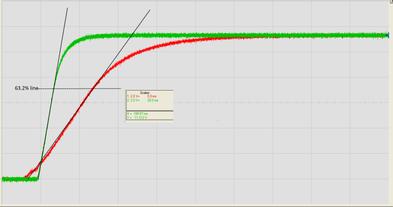

Thanks.
Sorry, I thought they were the same.
So, I will rephrase it to say, my 16mH (motorcycle ignition) coil provides a steady state oscilloscope trace, (monitoring current with an amp probe), of around 1.9A after 10ms, when connected to a 12V 7Ah battery (which is registering about 11.5V - it needs a charge).
I measure the coil with an LCR meter, which gives me a series resistance value also of 5.03 ohms, and a capacitance of 15uF.
To be honest, I only just bought this LCR meter so I am still trying to make sure I am using it correctly, but that's the numbers it gives me at the minute. Those are the values I put into LTSPICE to get the trace shown in my last post.
A capacitance of 15 uF? Not possible. Interwinding capacitance is in the pF (millionth of a uF) order and total capacitance ocross all windings is even less. Did you use that capacitance in the Spice model? BTW, 11.5 V from a 2 A loaded 7 Ah ackumulator isn't bad at all.

oops... I was using the LCR meter incorrectly, so I have simply removed the parallel capacitance value.
The 4.9 ohms resistance was measured using a Fluke multimeter, and the 16.624mH using DER EE LCR meter.
When I plug these values into LTSPICE, the results are pretty close to the trace as recorded in the real world on the scope.
I thought that was good, but I don't undestand the different equations shown above.

Below is shown the values defining the inductor and the resulting trace.

"I didn't take any screen grabs of the actual coil test so I will set it up again soon to do that"
Sorry to have done that already. This shows the same inductor in two different time scales (5 and 20 ms/div):
Tha data are 10 ohms, 11.5 V and 19 mH. The effect of high initial permeability can be seen in the 5 ms/d curve where di/dt is low during the first few milliseconds and then goes into a more constant L region.
No saturation in this run, that would have shown as an increased di/dt near end of curve.
