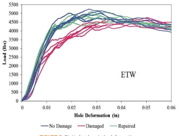

What's your basis for claiming that? I did a quick google search and it seems a commonly used method with experimentally proven results. One such example:
From the charts in that link it appears that all cases converge quite closely on the right side which indicates that there is no difference between repaired and unrepaired.
That's well past ultimate. At ultimate load there is a marked difference between repaired and unrepaired.

From the earlier link I provided, which was resin injection at holes:
In that instance the strength of the repaired specimins match the pristine specimins.
SW has said no no no, that test is irrelevant, because it's not a delamination failure.
So here's another link, on flexural delaminations, which when repaired have 93% strength compared to pristine specimins:
I'm sure you and SW will have your reasons why this test too is a load of rubbish, but honestly it's pretty hard to believe you when you're not providing any counter evidence. Since you're disagreeing with industry practice, how about you provide some test results which back up your theory that resin injection is of no use.
I commented earlier that the towards the right sides all of the specimens converge. You mentioned that the ultimate strength of the repaired specimens was better than damaged. Do we typically design around ultimate or yield strength?
Honestly, I don't think the chart is very clear. What is the failure criteria? The specimens seem to be yielding but never yield to a conclusion.
