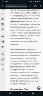

Phone screenshot is the best I can manage right now.

I believe this Airworthiness Directive is about adding some line items to the Maintenance Requirements Manual (MRM)
Airworthiness Directives; MHI RJ Aviation ULC (Type Certificate Previously Held by Bombardier, Inc.) Airplanes
This service information specifies new or revised tasks to detect cracks in the principal structural elements of the fuselage and wings.
Published format - https://www.govinfo.gov/content/pkg/FR-2024-03-05/pdf/2024-04557.pdf
Originating document, Transport Canada Airworthiness Directive CF-2022-35 : Time Limits / Maintenance Checks – Airworthiness Limitations – Tasks Revision
53-41-115 Overwing Longerons, Bottom Flanges
Terminology from ScienceDirect re: Longerons / Flanges / etc.
see also MHIRJ Service Bulletin

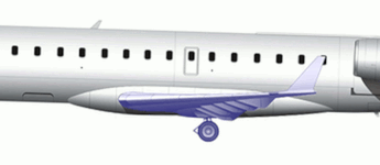

Image of CRJ900 Wing structure during manufacturing, to compare to wreckage photos above.

When the aircraft lands hard, the weight of the fuselage, including the engines, passengers and luggage, can punch through the wing assembly. This has an interesting affect which is visible in the animated landing gif. In Frames 5 and 6, the right wingtip is unusually low, even though the aircraft is levelling out putting down the left gear. If I'm correct, it's because the right gear twists the wing giving it a negative angle of attack which sucks it down. As soon as the aircraft puts all of its weight on both main gear, my earlier scenario takes effect and the weight of the entire aircraft whips the right wingtip upwards, Frame 7, at a rate the video struggles to capture.
The diagonal brace would break with the wingbox shearing. This would allow the right gear to assume any random configuration though apparently, the net forces kept it under the wing for at least a small fraction of time.

That's a great find,. I've been looking everywhere for details of the wing structure and not found anything.
So what's the actual connection mechanism at that shared connection at the back?
Rivets or bolts?
When I look at those photos it looks like the rear spar sheared off? The red circle? Or did the rear connection frame for the wheel go first and just bent this one?
